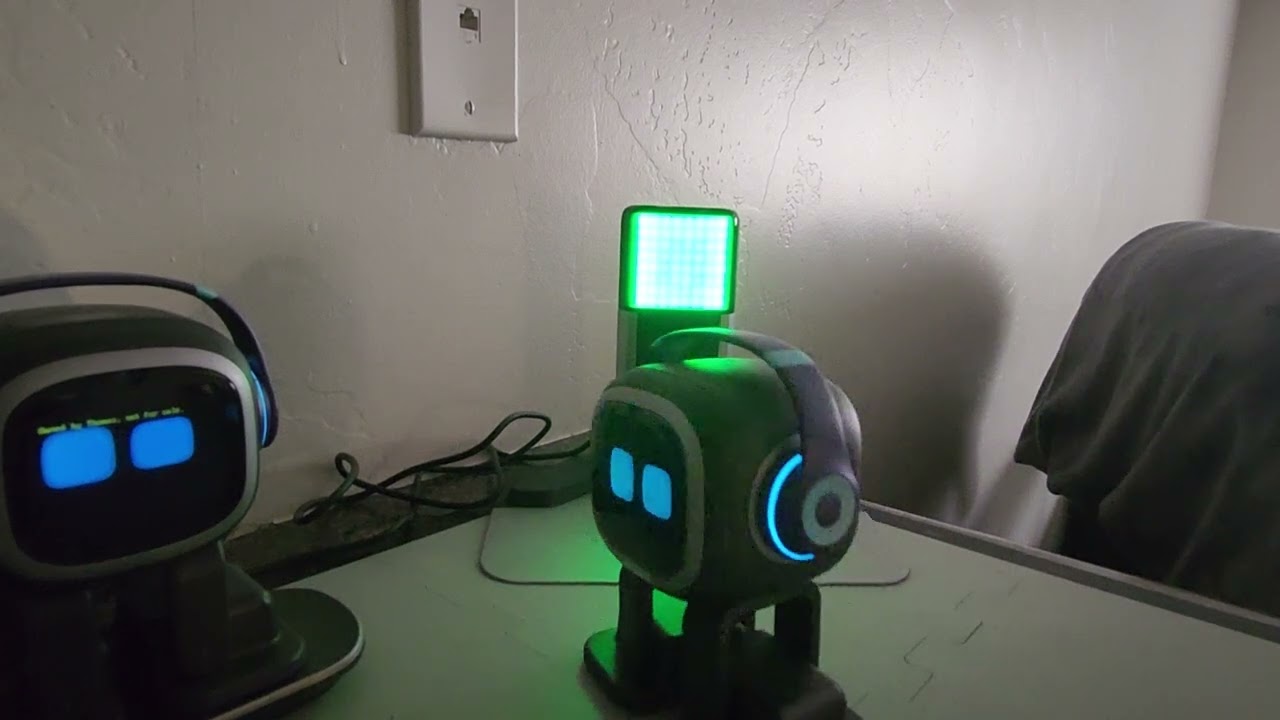

Me EMO as of today will not charge on the home station. I will put him on there and its like Home Station doesn’t recognize he is on there.
When I put him on a skateboard it charges fine.
I have unbinded him and he does connect to it again n fine. He will also go though the routine to find the home station to charge gets all tucked in, and then doesn’t charge. So he walks back out of it thinking he didn’t align properly.
I think the qi charging pad is going out on the home station. Is there a way to have it warranty replaced? Or more troubleshooting?
Here is a link to a video of how EMO is acting. You will see he gets in the charging station but no charge. Then just walks out. When I put another EMO on there it doesn’t charge either, but when I put the original EMO on the skateboard he charges fine.
Hi there @Tommyz182 and Welcome to the community,
Firstly, thank you for your effort in creating that video to share with us.
  • Did you check the Home Station mini light at the back of his legs? Is it steady or blinking rapidly?
  • Have you tried dismantling the Home Station once again, being very careful not to break the back tower connector, and then reconnecting it?
  • You can also try using a different USB-C cable and reconnecting everything once again.
Please view the video below for more knowledge, guide, and tips about Home Station
If the issue still persists, I advise you to contact the living.ai support team via email and send them the link to that video.
Please let us know here how it goes…
All the best
Thank You Edward. I tried taking it apart and putting it back together. As well as trying a different cable. It looks like its the same problem. EMO wont charge.
I did check to see if any light comes on behind EMO’s legs, and there is no light coming on at all. So, I am thinking the base might be bad. However, when I press the button on the base though to change the lights to different designs that works fine. So, it also leads me to believe that maybe the charging coil is just bad in it.
I did reach out to support. So, I am hoping I hear back soon. Thank you again for youre help!
