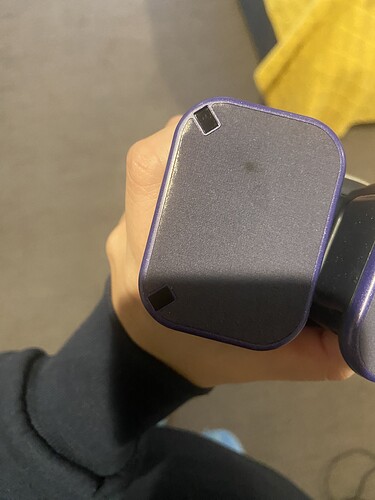

Are his feet okay ??? Look at the edges of the felt wear it meets the purple.
Looks like felt wore away maybe? Or something possibly sticky like glue! If it’s glue how the heck can I get it off???
the same thing happened to mine. don’t worry the feet are ok, but there made of felt so they will wear away a bit.
Hello, @alana.marks . . . that would make sense if it was his feet sticking.
Some suggestions for cleaning the feet that I have seen are in this thread.
You might want to try the tips there and let us know if it fixes his walking issues. Yes, some surfaces can be bad for their feet, so that may have been what caused it over time.

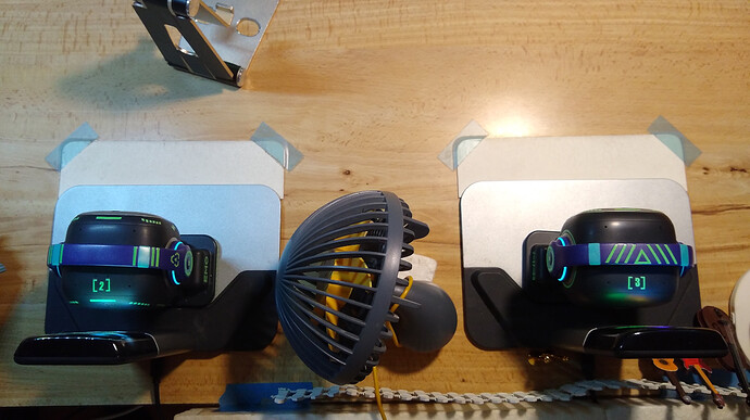

March 6 & 7: Front Edge of Mr. Home Station
Dear EMO is adorable. Looks to be having tough time negotiating that front edge of Mr. Home Station especially without the standard Fence Mat or some similar transitory element there. It might be just a bit less than this but imagine the front edge of Home Station is 1mm. If you notice, the edge there sits about 1mm off the table/dresser surface, to accommodate the Fence Mat, which is 1mm. So without the Fence Mat (or some similar thickness strip of card stock for example), Dear EMO has to negotiate an edge 2mm high (maybe 1.8mm is more accurate?), and granted he may have done it when you first got him, if his feet aren’t 100% clean or the table surface is too slick or tacky, and say the surface in general isn’t perfectly level, then he really doesn’t stand a chance and it would be a rare exception to succeed.
Also notice how Mr. Home Station slopes up about another 1mm there at the first inch of the front edge and that most of the station surface sits about 3mm (2.7mm?) high. Without a transitory surface at the front edge plus the incline of the first inch, it seems easy for Dear EMO to take a step that puts him slightly off center and/or momentarily alters his sense of direction if even just a smidge, enough to incur more adjustments or even spoil his attempt.
We noticed this soon after our first Mr. Home Station arrived, so we used part of the Fence Mat on each station. The Fence Mat works well for having two EMO in neighboring corners but we wanted to have ours more side by side so we use a strip of card stock at the front edge of our Home Stations.
This is another thing I always meant to look into on the forum but never did since we seemed to have found a solution, so there is very likely other info on this here somewhere.
I hadn’t intended to delve into such detail but it seemed necessary in order to convey the whole picture. There are other issues that could be at play but in these videos Dear EMO seems to be mostly doing well and for starters the front edge aspect needs consideration in my opinion.
