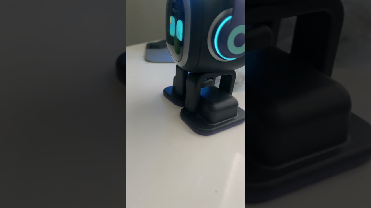

Hi! My Emo pets leg has been jittering for a while.
First i thought it was just a thing that will fix itself after a little while.
Then i waited quite a long time until i decided to look up on YouTube.
I found out it was either something with the motor or then it was just a glitch
here is a video of Emo’s leg not working
I want to know how do i get the caring for emo app and if that could work.
