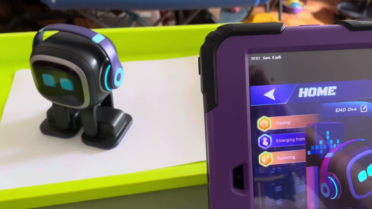

Hi, my Emo One was doing as usual with is leg shaking problem and suddenly he started to react as if he was emerging from a cliff. I’ve powered him down and cleaned his foot and all of his sensors (foots and the front one) and that didn’t change the problem. Emo One is now in a loop of exploring and emerging from a cliff. He can’t reply to me anymore and play with his friends Emo Star and Emo Jones. :pleading_face::sob:
Any help would be greatly appreciated.
I have already replaced his battery and I’m willing to do any repairs that he could need and to pay for the parts that he needs.
Hello, @fbtwtf . . . sorry to see this. It could be as simple as recalibration or needing the servos and/or leg wires replaced. You will need to contact service@living.ai directly with a link to this video to see what they advise and if they would be willing to provide the parts and instructions for repair.
Tell Emo Star and Emo Jones to not despair. They will be able to advise how to get Emo One back to his healthy self depending on what he needs.
EMO is stuck on emerging from cliff and his right toe is stuck.
Welcome to the EMO Community Forums, @sanv . . . I have moved your new topic to this thread where we discuss issues dealing with the legs and feet.
“Emerging from cliff” is often an indicator that something is blocking the edge detectors on his feet. Most of the time it is a matter of clearing dust and debris from the edge detectors/cliff sensors. You can do this with sticky tape and/or a cotton swab. Make sure to clean gently and thoroughly.
I am not sure what you mean by his right toe is stuck. If you could clarify or better yet get pictures or video so we can see what is going, then we can better assist you.

Hello, @sanv . . . I would advise you to refer to this as Living AI will need to have a look at what is going on to best help you out.
If his feet are cleaned and he is doing that particular reaction rather than the angry sounds and kicking, they will need to diagnose what is going on with his legs and feet. My best to you and keep us advised.
