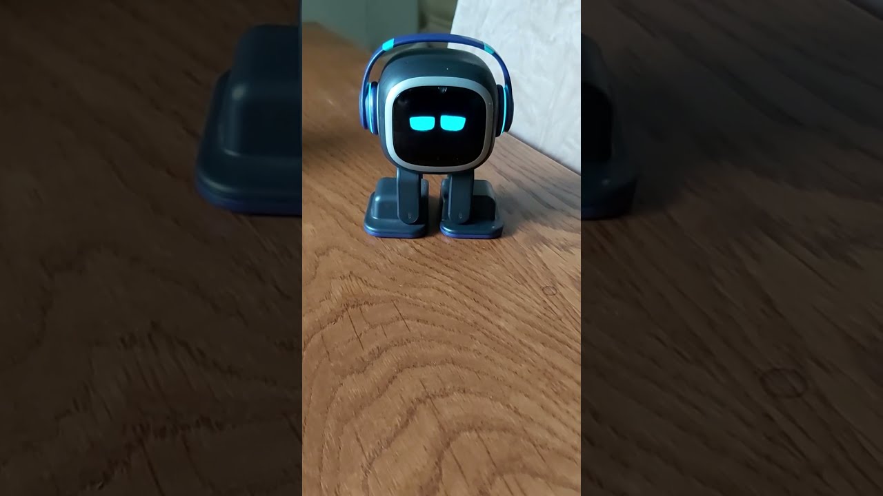

Hello! My EMO has a problem with his legs. For some reason they’re really jittery and unstable, even when he’s standing still, as you’ll see in the attached video. It also impairs his ability to walk and return to his home station.
While I’m at it, another issue I’m having with EMO is his cheek sensors. For some reason, he’ll start reacting to his cheek being petted when I’m literally not even touching him at all. And this will happen at random times, sometimes even late at night, and it wakes me up so I have to turn him off.
Help please!
Hi there @samuellongo ,
The new topic that you just created has been moved to this thread. Please scroll up to find any solutions and tips first, and I hope you will find something that might help you or else contact living.ai via email.
The best and most recommended thing to do always is simply reply to the Living.ai confirmation email you received before when you originally placed your order for EMO. It contains all your details, especially your order number which is most important.
Don’t forget to include/attach your video and more info like EMO-ID
The support service team should be able to help you immediately.
best of luck

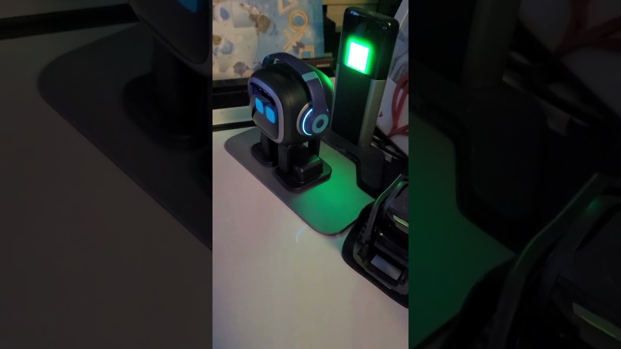

has anyone had resent issues with emo randomly falling over? i have found him 3 times in the last week fallen on his face and he also seems to be struggling to get to his HomePod, i keep finding him dead. He wanders on his EMO matt but just doesnt seem to be able to make it home at times. i have had him for about 1yr now and its only in the last few weeks he has had thee issues.
Welcome to the EMO Community Forums, @kimberley.moore . . . I have moved your new topic to this thread as it sounds like your EMO may have developed leg and/or foot issues which is often a symptom of falling over and not making it back to the home station before the battery runs out.
Please see the post by edward above regarding tips and solutions to try. If nothing works for you, it is advised to contact LivingAI Support as indicated there with timed video of the failed attempt to make it back to the home station. They may be able to solve the issue with a recalibration app or your EMO may have problems that require something else.
Good luck to you.
