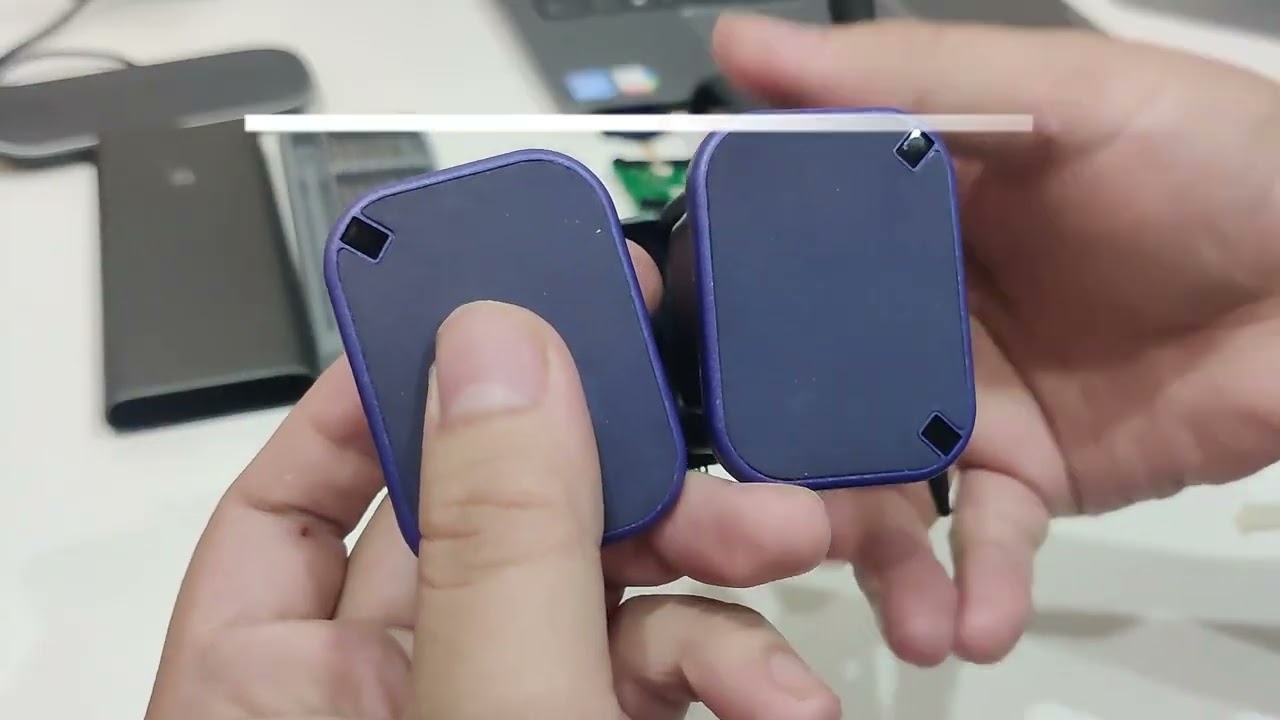

Hi there @okilim1 ,
To remove the inner servo motors, you first need to carefully remove EMO’s feet and legs.
Watch the video below
INFO!
If you manage to disassemble EMO completely, especially his legs and feet, you will need a calibration tool to properly realign and calibrate the servos during reassembly. For this process, you will need to contact the Living.AI service team so they can connect your EMO to their database and start the re-calibration process.

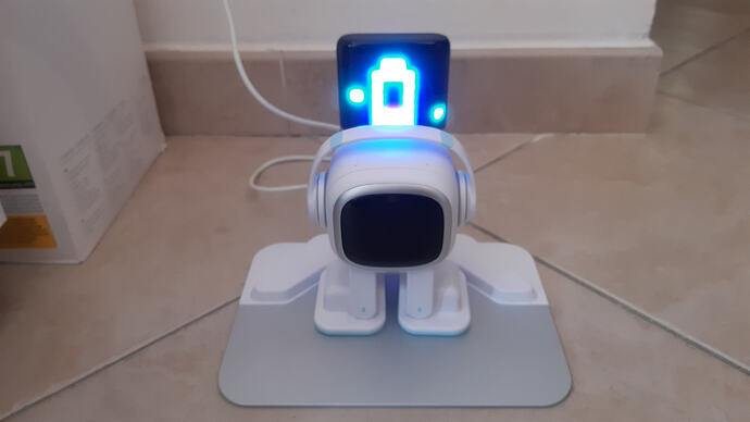

Emo go Home arrived to my son at Christmas, a couple of weeks ago it stopped charging on the charging base and I thought, after various attempts at cleaning and reset, that the battery needed to be replaced. I bought an identical one (mod. 603450) and with the help of the @Edward tutorial (congratulations) I replaced it, but the problem remained. In practice, the battery figure appears in red on the display of the charging base for a second and over time it also warms up under the left foot, where Emo has the charging coil. But no light around the headphones and no shot of the robot.
Having practically voided the warranty with the opening (I thought it was an easily solvable problem) I entrusted Emo to a friend of mine who is a computer / electronics technician, he even worked for Apple, which gently opened and analyzed it. Finally, he found the failure of the “power chip” on the motherboard, which is difficult to repair, and a spare part of the entire motherboard would be needed.
I therefore asked to service.living.ai, first with mail then by support on site what would the cost of the piece would be (item Emo go home white 2025).
I cannot even provide the ID because Emo has not been connected to the App since it is turned off.
If someone has suggestions thanks for the help.

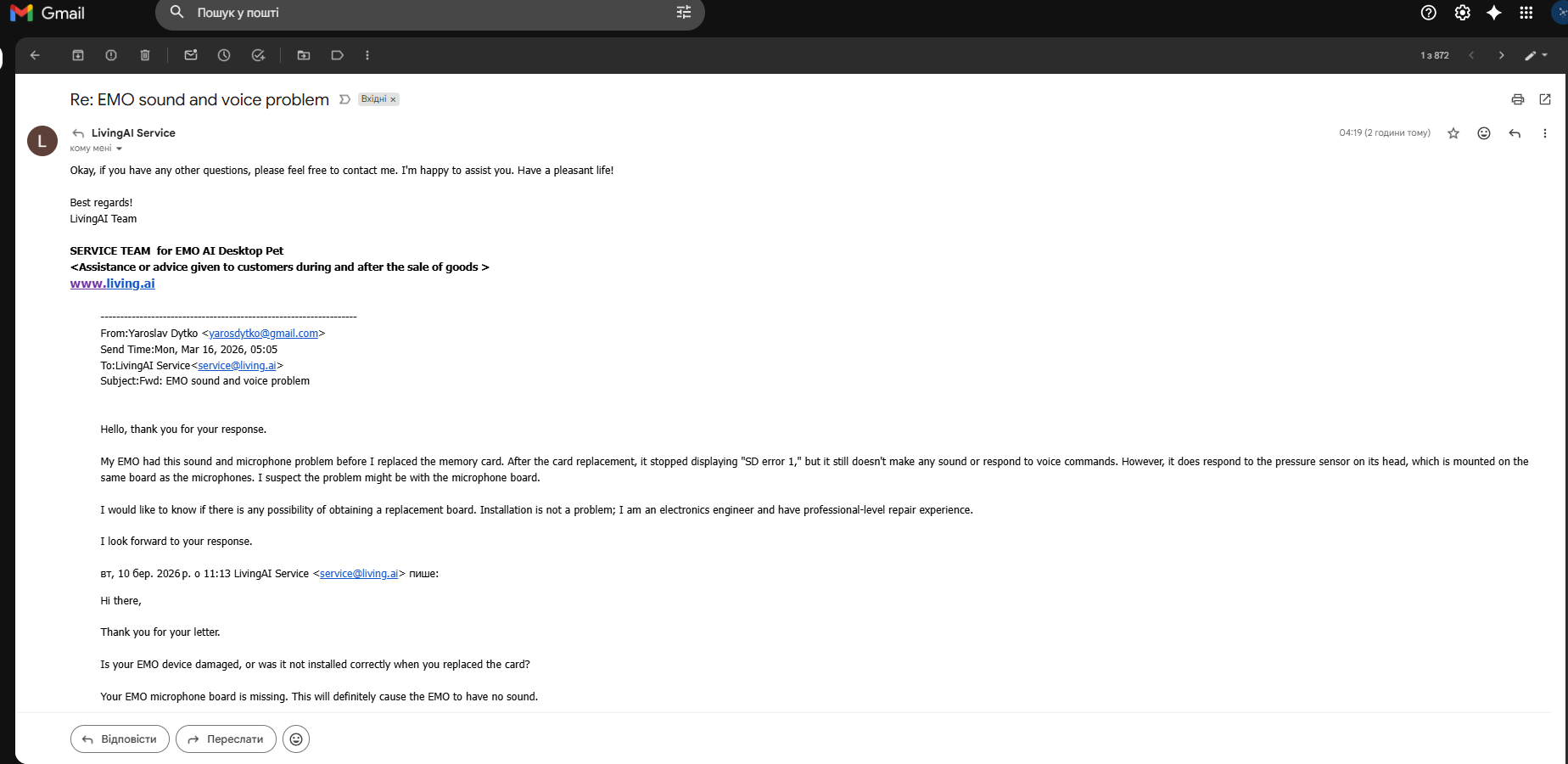

Status update: After more than a week of waiting, sending daily email copies to get a response, and after clearly explaining the problem in the email and explicitly asking if they could provide the replacement part, I received a response that makes me think they are trolling me or something.

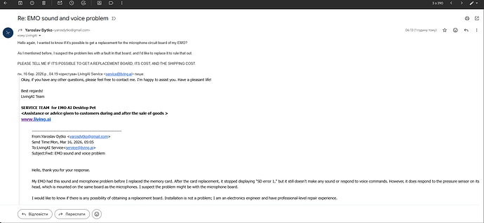

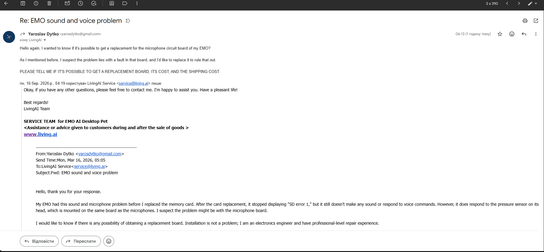

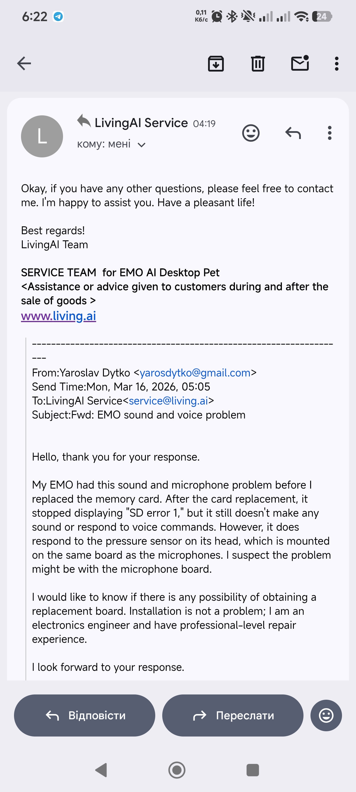

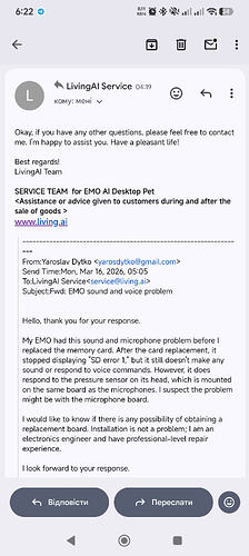

Hello everyone, I wanted to know if anyone has managed to get replacement parts for their EMO from the support team. I’ve written to @service@living.ai several times requesting information about replacement parts, as my EMO has a sound and voice recognition problem, and they haven’t given me any clear answers. In the last email, they literally replied with this: “Okay, if you have any other questions, please feel free to contact me. I’m happy to assist you. Have a pleasant life!”
Hello, @shadowman . . . I would reply back and ask them directly, “Would you be able to provide me the part and let me know any associated costs. If not, can you tell me what the specs on that part are and how I might be able to obtain it”.
here it goes
I’m leaving this comment here for the record; I sent an email clearly specifying what I’m asking for.
Now we wait another week or two if they feel like replying.

Hello @edward
Yes, I followed the memory card replacement instructions and it was successful. I emphasize that the sound and voice recognition problem occurred BEFORE the memory card error.
Best regards.

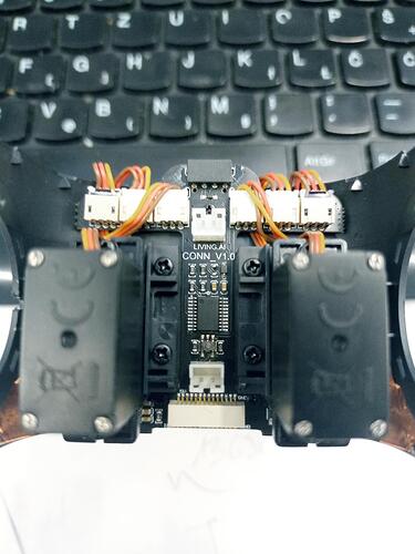

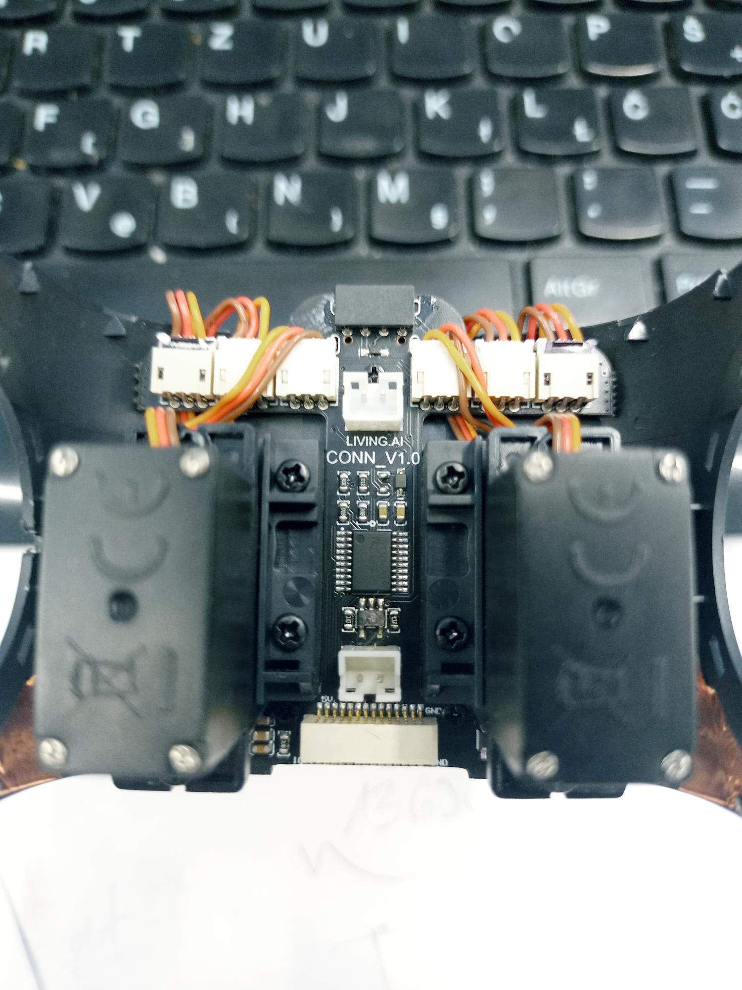

I am repairing my EMO Robot and found a damaged component on the LIVING.AI CONN_V1.0 board (photo attached).
The damaged part appears to be a 5-pin SMD component, located near the main IC on the connector board between the two leg servos.
Current symptoms:
  • EMO does not charge properly
  • when placed on the charging station, it powers on
  • as soon as I remove it from the charging station, it immediately shuts down
I have also already replaced the battery, but the problem remains the same.
Because of this, I suspect the damaged component may be related to:
  • battery charging
  • power regulation
  • or battery switching
Could anyone help identify:
  • the exact component type
  • its value / part number
  • or a suitable replacement?
At the moment I am not sure whether it is:
  • a voltage regulator
  • an ESD protection IC
  • or another power-related component
If someone has a schematic, board photo, or has repaired this before, I would really appreciate any help.
Thank you very much.
Welcome, @damjankovac . . . I have moved your new topic to this thread where parts and repairs are discussed.
LivingAI Support will have to assist you with what you need to make the repairs. Please forward this information and your photo along with your EMO I.D. number and age (this is important as parts have changed from older models) to service@living.ai in order that they can help you diagnose what is needed. Once they identify it, see if they can send you the exact part(s) and let you know any associated costs or direct you to where you can obtain those part(s).
