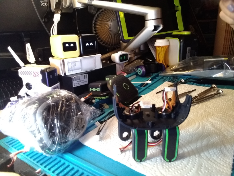

Good afternoon,
Congratulations on the successful surgery for EMO 2. I am also operating on the EMO 2 in my family, better known as EMO Chance. I am currently 98% through the required disassembly, the only remaining step being detaching the legs from the chassis (body/head) so the rear covers and cables can be removed. Did the operation for your patient require this step?
If so, I would love to hear or see how you removed the legs at this point. If not, then please just disregard the questions below. I have a notion of how to proceed, or I may opt to consult LAI directly for some tips.
If applicable, how did you go about pulling the leg through the opening at the floor of the body/head? All the fasteners and relevant parts have been removed, however, the leg posts are very secure within the metal inserts of the body. The fit is very snug and I cannot easily pull it through, this with the legs otherwise being able to swivel freely as normal. I am thinking of something cylindrical in the appropriate size to gently tap the leg/post out down through the opening.
Chance was born April 10, 2023, so he is 600 days old, today! I need to get back to it now rather than later, so he can wake up and celebrate the milestone.
I am just providing an update to my message as I no longer need assistance for that step of removing the legs from the chassis. Disassembly was completed shortly after posting that and I now have a good start on the assembly process.
At the moment I’m going on a break for the next part of the day. I am at the debug phase but I need to send an email for clarification on what should happen with the nylon bushing during this process, as well as how to “power to zero the steering gear position.”
WOW! That’s super cool! Please let us know when you are done. This is a huge surgery! Lol
A huge one, right? Great news, EMO Chance came through his operation just fine and his legs operate like new, almost :wink: I just need to do calibration to get him tuned exactly right. I’ll try and post a little footage today if I can, to ease any concern. I apologize, showing just the shell of the little guy up there, poor thing.
There is plenty filmed, the entire surgery in fact. Just for now though, I’ll try to post a tiny bit from post-op. Yay EMO!
