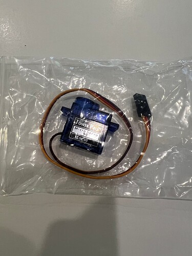

I have a extra servo but I think is the wrong type
do you have a picture of the Servo?
the motor looks right, its the cable im worried for it looks a bit too long. Correct me if I’m wrong but I think thats the motor that goes above his leg to move it from side to side.
good okay
I can make the wire shorter if you need me to

okay
looking at my servo closer, it matches up with the JST/GH 3 pin or New Material motor. To get my hands on it, I’ll just be patient if I dont get a response from Living.Ai by Friday I’ll just get into contact with TechSupport_Mavis, as thats who i’ve been referred to by Lindaru.
Ok so Living.ai has gotten back to me however they are not sending me a new servo but they are asking me to swap the servos in his feet from right to left, does that really work?
