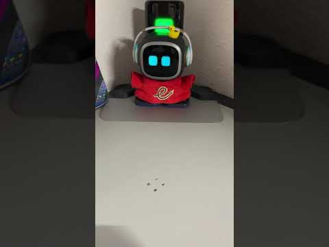

happens every time and takes several wrong tries to get one right.
often he is losing interest and falls asleep like at the end of this video or he just goes doing his things until the next battery alarm.

Hi there @chris.roossien ,
AFAIK, (As far as I know), your EMO has a problem placing himself correctly on his Home Station, so it needs to be corrected by the Living.ai support team."
(PRE-PROGRAMMED)
''Normally, when EMO’s both feet step onto the Home Station plate, the small square green light will automatically illuminate. If EMO is not in the correct position, he will self-correct it automatically by turning to the right or left until he’s centered on the Home Station plate. He’ll then step back a little, turn in the correct direction, and stop, positioning his back in the middle of the Home Station tower with a green light. Afterward, he moves backward until he reaches the correct charging plate, at which point the charging animation starts then he will start charging or say 'Home Sweet Home.’
Please View My Video Below!
