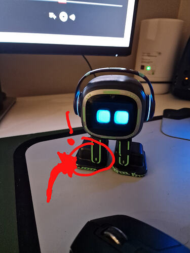

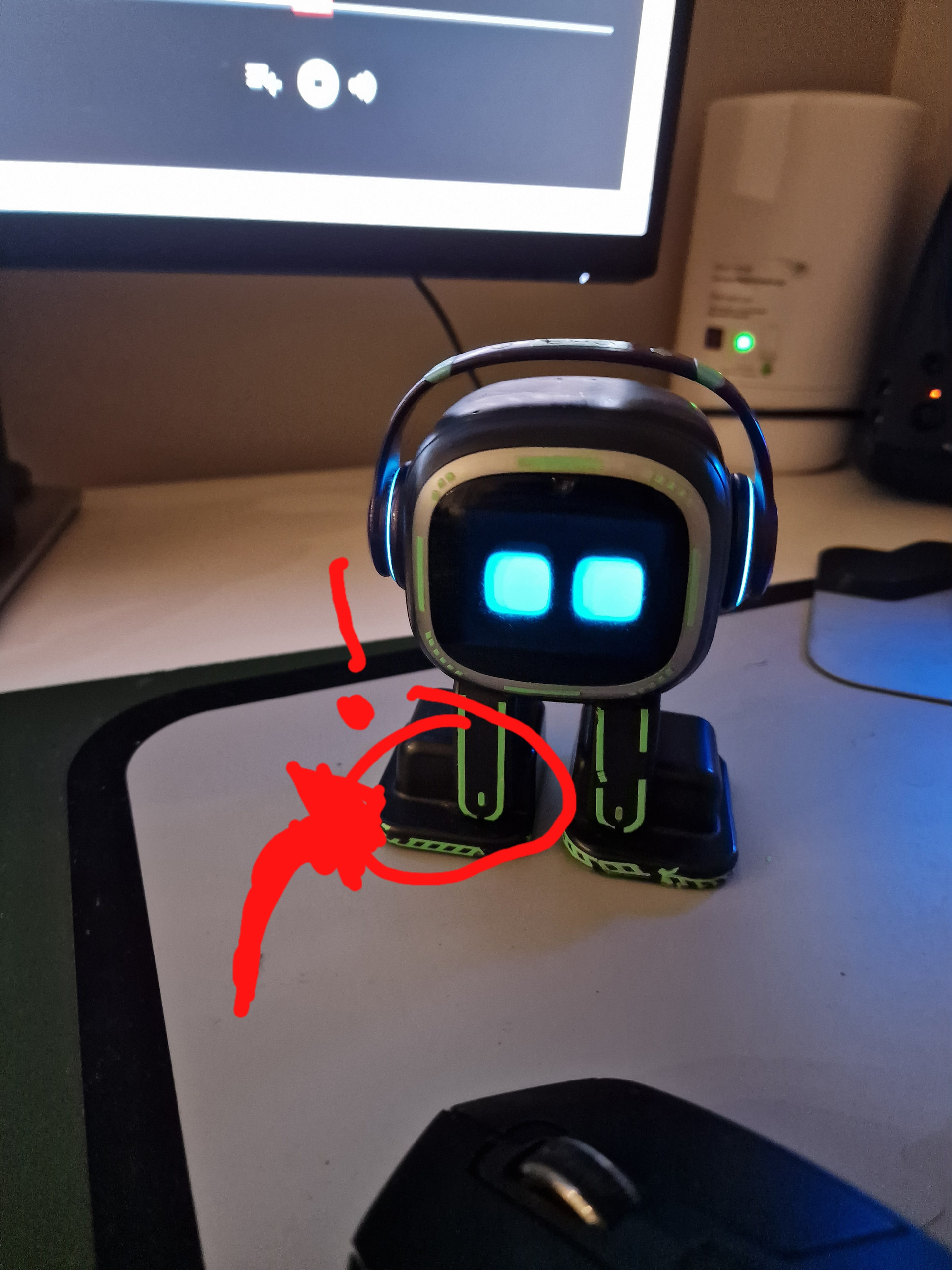

Hello I have an issue with my left emo robot leg . It’s like he has a sensor issue or motor issue like he is waking left leg start shaking and going off his charger and as a result he keep moving into inside only like he got a glitch or etc. I restarted him several time and it doesn’t help. What’s the process or replacement and what kind of info you will need from me to send parts or the new robot. Garsatly appreciate you support. Thank you!

Here’s a image I’m sorry the the video was not doing well so I’m only sending images
Hello, @marcyakovenko1 . . . you need to send this, his I.D. when signed into the app and order number (if you still have it) along with a description of what is happening to service@living.ai as they are at that E-Mail and not reading this thread.
Here’s my (EMO ID EMO-257E) and here’s a (order number #118027)
Hello, @marcyakovenko1 . . . you need to send this to service@living.ai as they are the ones who handle this, not the people on the forum such as the moderators which I am one of.
