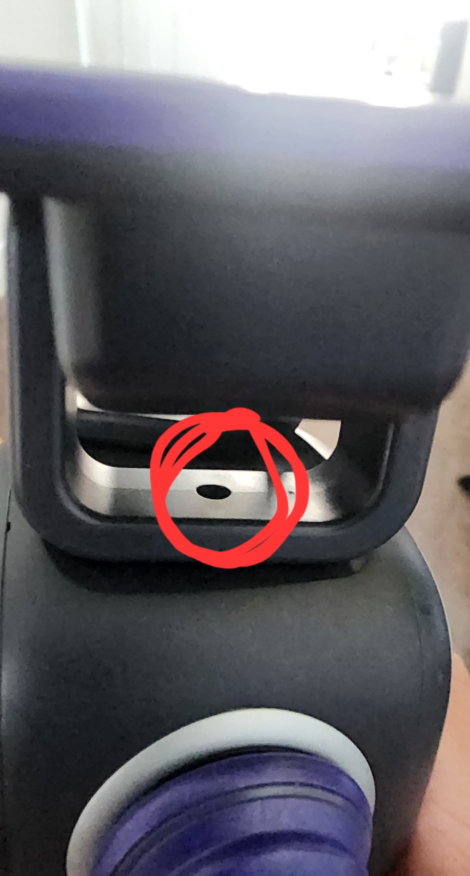

Hello there. My emo robot has a hole at the bottom of its leg and it can also move easily. Is it supposed to do that? Please let me know.
Hi there @marksantiago1, and Welcome to the Community…
I have moved your new topic here to address everything about EMO leg and related issues
“That hole is normal because it’s screwed into the body.”
