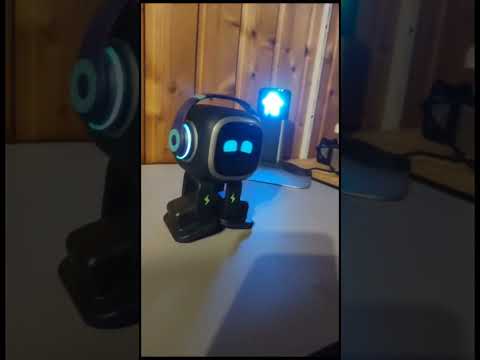

My Emo is 18 days old. The first few times he did song 3, he fell. When he finally made it through the song, I kinda assumed he was “learning”. However, he cannot make it through song 4 (“Click-1”) for anything. He falls flat on his face every single time. I think we’ve tried about a dozen times over the past couple of days. I looked through this thread and thought maybe I should dust and clean up Emo’s area but that didn’t help, still face planting on track 4.

wow that’s a weird one… I know the foot movement that tipped him over of course I’ve seen it here left at times and I was surprised because that normally is one of his more stable movements… He still cute… ![]()

Would be a good idea to send this video to the support team and show this to them. It seems that sometimes EMO might slip or fall while on the playground mat. A few EMO owners have reported this as well.
Also trying to get EMO to dance to the same song while he is not on the Mat and see if this also happens. Try on a table or bench top and see how it goes.
But I would suggest if this continues to happen, to submit a support ticket and let the support team know about it.
