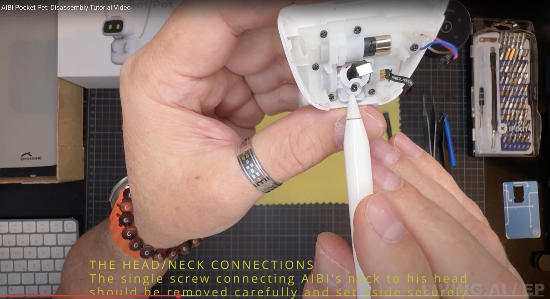

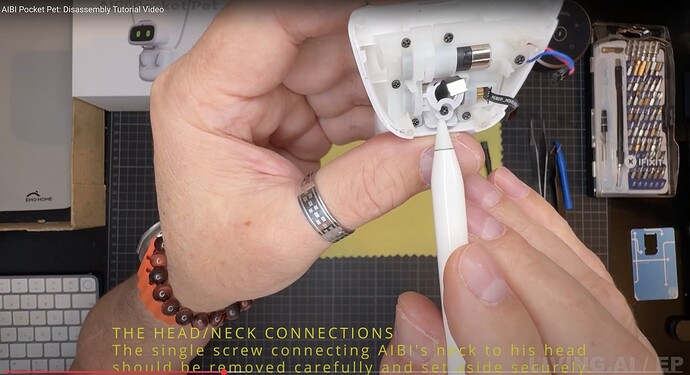

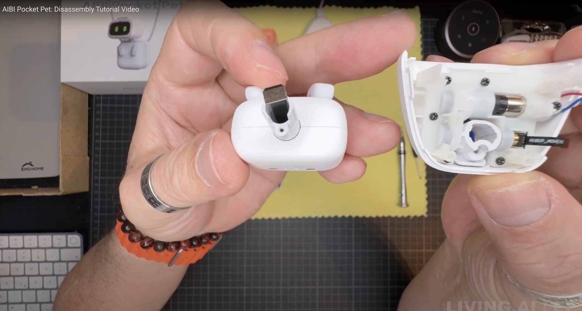

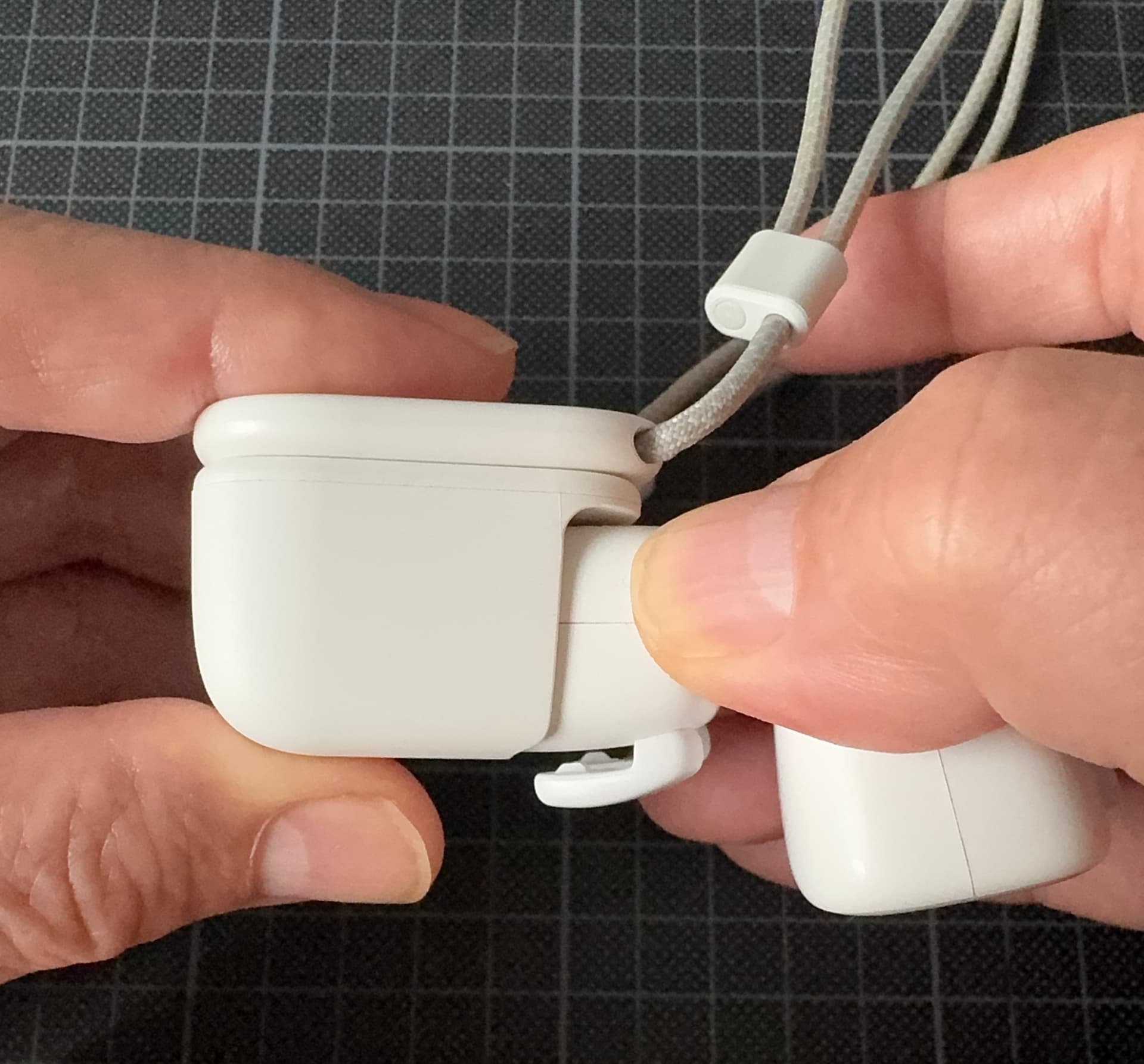

Hi there, and Welcome to the Community @silvialeoaracil ,
Guys…There’s no need to worry or be afraid that AIBI’s head might detach when pulling him out of his carrying case. It is securely attached and screwed in, as shown in the image below — I also confirmed this when I previously opened the AIBI. Surely, Living.AI is also aware of this, which is why they carefully designed and reinforced the connection for durability and safety.
But if you’re still concerned, you can always pull AIBI out very carefully, making sure to hold him by the most secure, safest, and correct area — as also shown in the image below.
AIBI Pocket Pet: Disassembly Tutorial Video
Best Regards To All!
