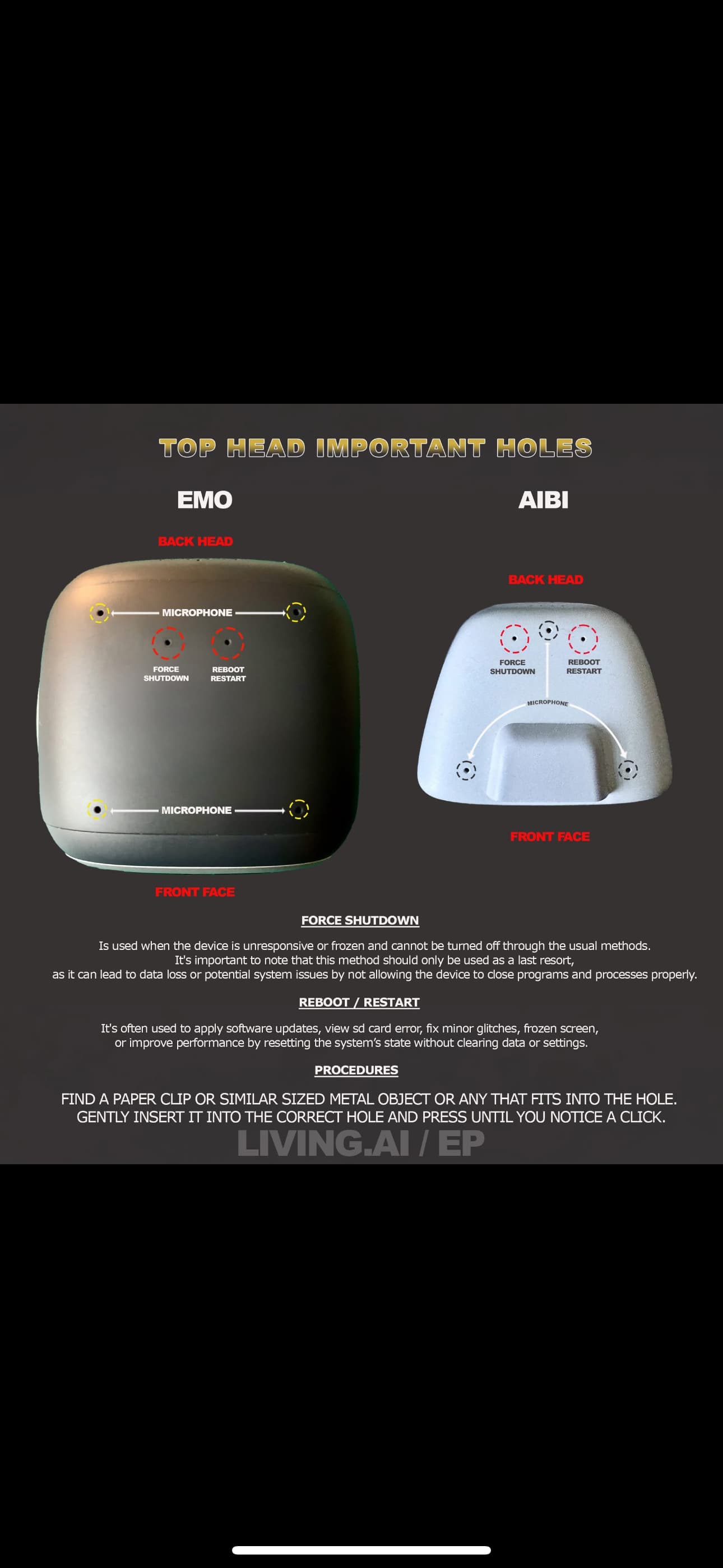

@Lindaru I have tried multiple cables and she is connected to the base just fine. She has a full charge, but yet turns off about 17 seconds after I remove her from the charging base.
Not even really fully shutting down as she doesn’t make the shut down noise or lower her head, there’s a small pop and then no power.
have you tried these top 2 holes with any luck?
@R0botfan I did, the force shutdown button did shut it down she started back up when I plugged her back in, but still had the short shut down issue. When I pressed the reboot button, she again shut down, but then also cycled through the start up process for several minutes without actually starting up (the lights on the charging station would come on too even though it was not plugged in).
Hi there @Eilonwy79 ,
Have you already tried letting your AIBI use up his battery juice and shut down by himself?
You can also try to place him on the charger and poke the right hole (Reboot/Restart), then observe if it helps.
If nothing helps at all…
Your AIBI is still under warranty.
I recommend recording a short video showing the issue and contacting Living.AI Support. You can do this by replying to your order confirmation email or sending a message directly to service@living.ai, including your order number and AIBI ID.
