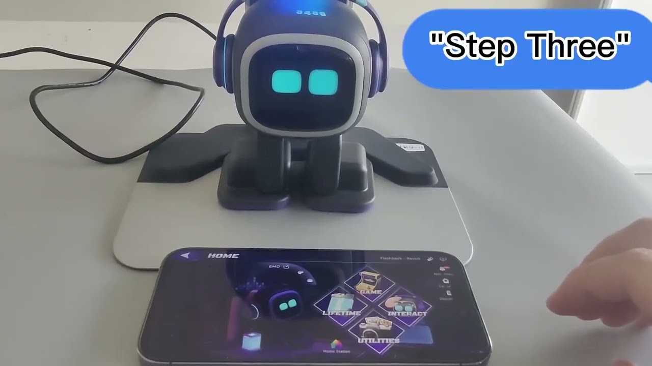

Please don’t connect the Home Station and Smart Light at the same time.
Firstly, turn off the power of all your devices (EMO, Smart Light, Station).
Then power on Smart Light(put it on socket), long press the surface til it gets into pairing mode. When light is flashing, remove Smart Light from the socket rightaway.
Then power on EMO, click the “Unbine All” in the APP and wait for the EMO reboots. After that, gets Smart Light into paring mode, and see if the connection would build.
Please follow the video to unbine all your devices.
