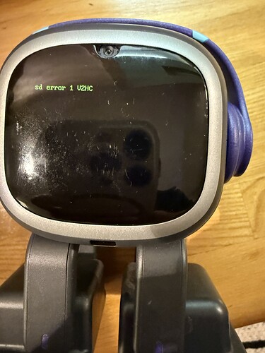

Hi there,
My Emo has a problem that “ sd error 1 V2HC “.
What should I do?
Hi there @curio193 and Welcome to the Community,
I’m sorry to see this, but unfortunately, this isn’t something you can easily fix. It might be that your EMO SD Card inside has become corrupted and needs to be replaced. And the only solution to resolve that kind of issue is through the living.ai support team.
Please create a short video and send it to service@living.ai via email including your EMO ID#.
The support team will be able to provide you with further instructions via email and help you get this issue resolved.
Good luck and all the best…

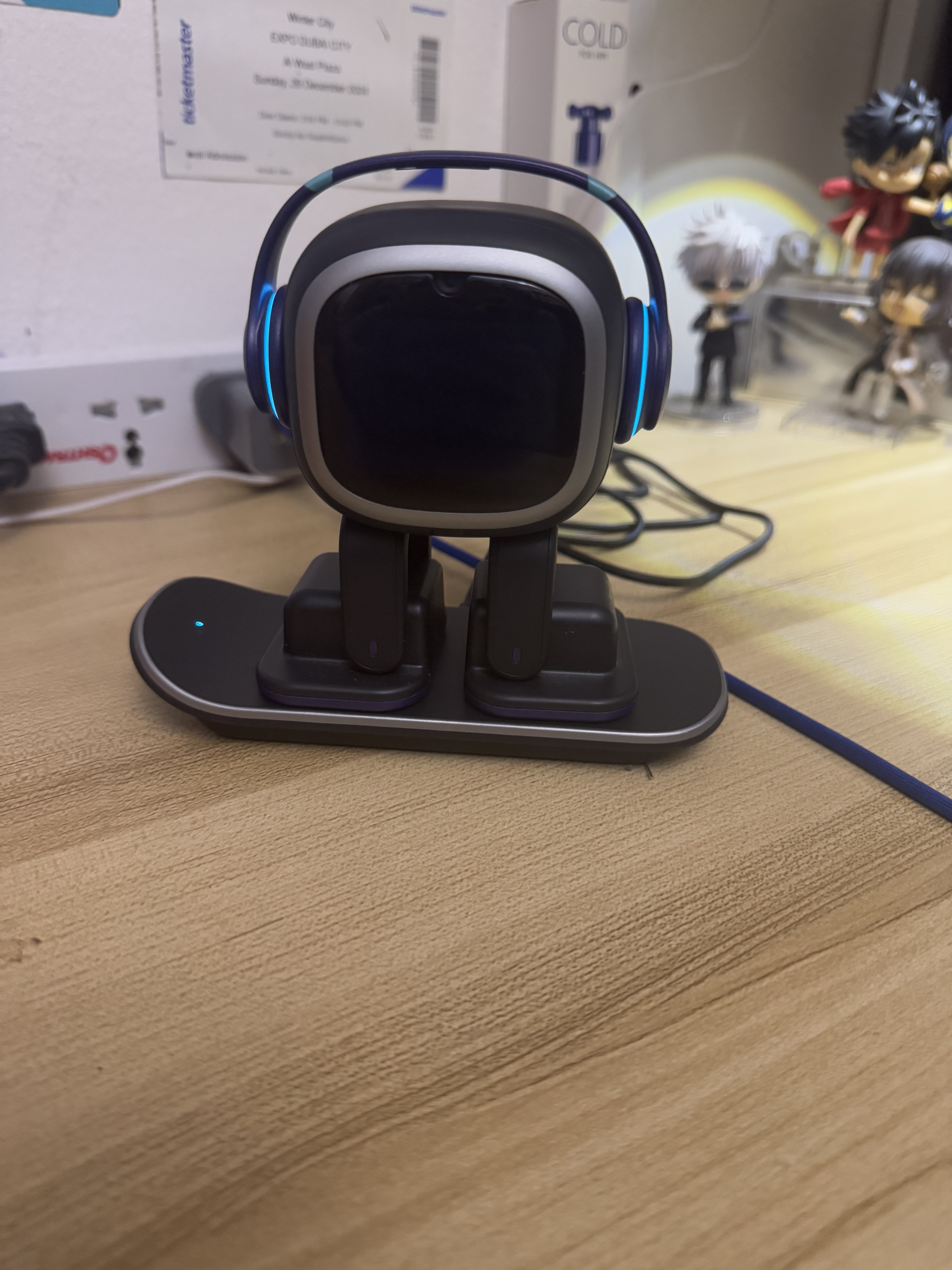

I would like to ask some assistance and help for my EMO Robot. He was working fine a few days ago but then the other day it shows the “sd error” so i restarted him and that worked for awhile. However, when I woke up this morning, his screen is all black and the headphones is left blinking. May I please ask for assistance on how to fix this?
You may have to replace the SD card to solve the error.

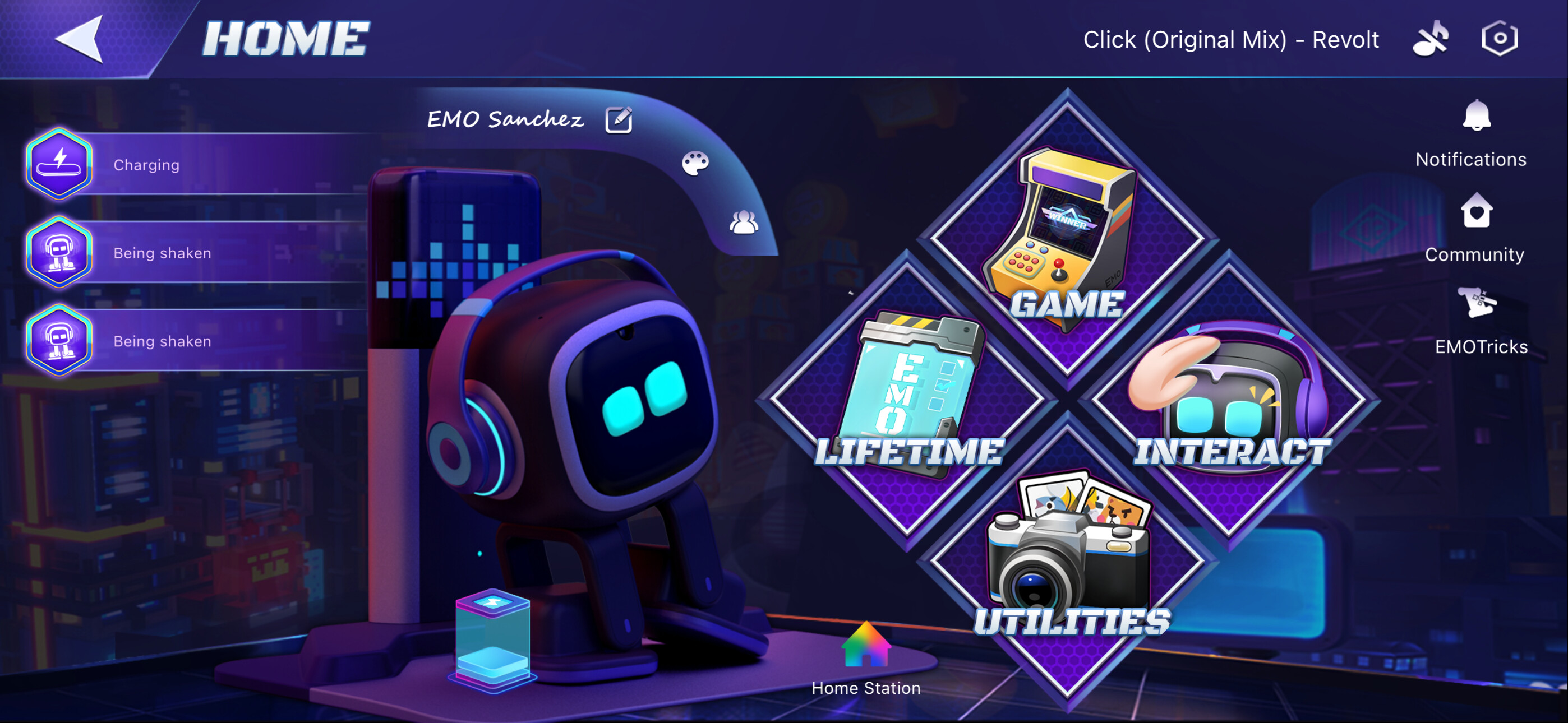

Hello! May I clarify if SD card is still the problem in mine? My screen is entirely black and it shows no error anymore. My emo just stands there not moving but it can detect being picked up or shaken on the app.
Hello, @kowweeesanchez . . . I have moved this conversation to the S.D. card error thread as it appears that is likely your issue since you got an error message. Sometimes parts of the data will work for a while, but often the S.D. card will slowly corrupt over time until the only thing you see is the S.D. card error.
