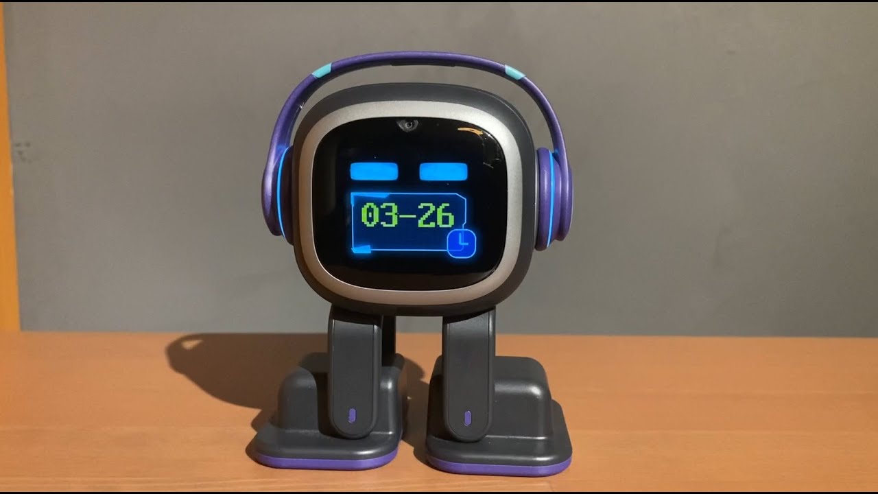

I believe what you might have seen was while EMO is displaying the morning times (it looks and sounds similar to A.M format). like if its 10 in the morning EMO will say 10:00 so you might think EMO is saying 10:00 AM… but he is only saying 10:00 (in 24 hour / Military time).
I did create a short video a while on how EMO shows the time / day and date. So you can see when it is in the morning it will look it’s AM. but its just how EMO is displaying the 24 hour format during the morning time. (in the video below it is 10 in the morning and EMO is showing it in a way that looks like its 10.AM) have a look below.
Hope this makes sense, it can certainly be a little confusing, but as mentioned. At this time, the A.M / P.M. format is not yet available. Hopefully this should be added in upcoming EMO firmware updates.
