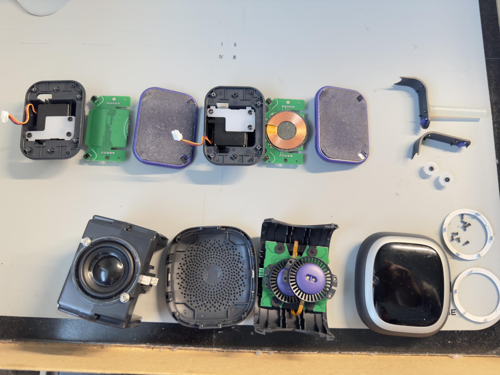

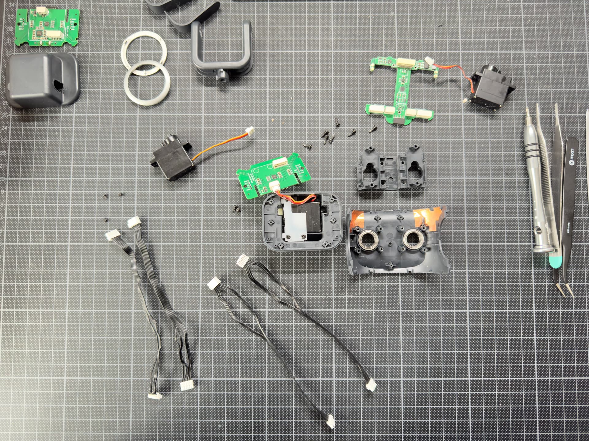

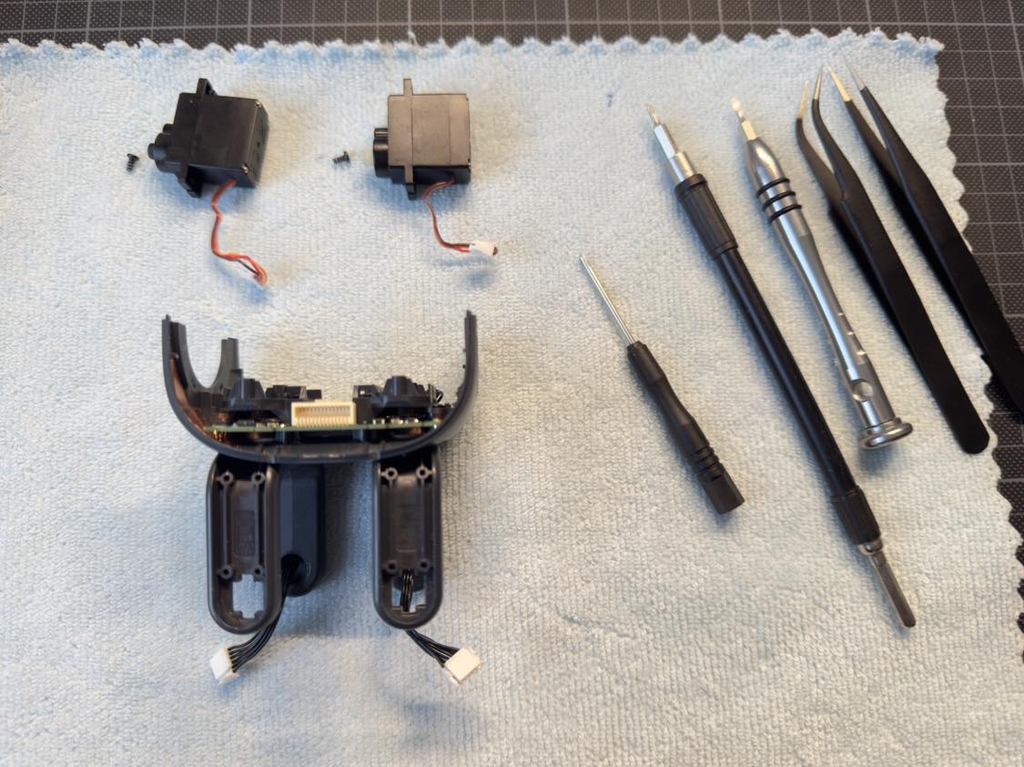

As I noticed that EMO PIKE (786 days old) was struggling to turn left or right as well as lift his left leg, making it difficult for him to walk, I suspected a damaged wiring. I decided to take him apart piece by piece and discovered a broken wire in his body that was directly connected to his foot.
So I decided to replace all four cables and servo motors in EMO PIKE. Then I contacted living.ai AfterSales Staff MavisZhang to connect EMO PIKE to their cloud server and initiate the foot recalibration and debugging process, which is a crucial step after changing cables and servo motors to ensure the correct alignment of his legs and feet.
As far as I can see now, EMO PIKE is working fine. His legs and feet can move, walk, and turn freely, just like before.
