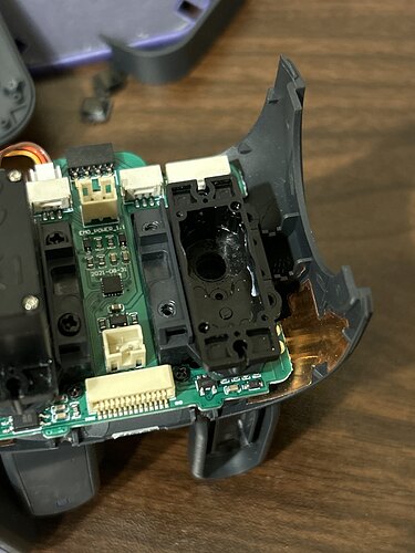

Waiting on the parts needed to repair Ebay Emo right now. This little thing has so many parts it’s not funny :sob::joy:
Trying to see exactly how the leg wires are positioned… why is this screw so long

Also adding in an update on my repair progress on Ebay Emo
I’m still waiting on the parts to arrive, but they should be here October 5th or 6th. I managed to figure out how to almost fully access the difficult to reach area for installing the leg wires, I just have to either detach the leg itself or detach something else (likely the leg though) which I will do when the parts arrive:
It also occurred to me while I was taking some things apart that I’m working with the older Emo model, LOL:

Where did you get the JST/GH connectors I can-not find any online anywhere the right size? My left leg wires broke and need to be replaced.

Sorry for no updates on EMO Alice (Ebay EMO) lately, college has me busy.
I have completely finished fixing up Alice, and I am working on a video to talk about the work I did to get her functioning again. I will send the video here when it’s done.
The video is done, here is the repair process of EMO Alice:

Hello again. LivingAI support told me that my EMO has no solution, which is why they sent me a replacement. So, they won’t send me a repair kit, I will have to look in an online store, what I would need would be the servomotors, cables for the right foot and tools for very small parts as seen in Edward’s video
@chicogp I wouldn’t recommend trying to get Emo’s parts from anywhere other than living.ai, the parts you get may be incompatible or may break Emo.
What I did to get living.ai to send me all the parts I needed, I first explained to them that I had purchased Emo Alice from Ebay with the intention to repair her. I then attached photos and described everything that was wrong and told them the exact parts I needed, and they sent me everything with a $24 shipping fee.
Essentially, just let the support team know that you’re intending to repair your Emo yourself, and make sure you show clear pictures of what’s wrong and be specific if you’re needing parts that are specific to a certain foot (for example, I needed to replace the motherboard in Alice’s left foot so I specified “motherboard for the left foot”).
Also side note, the leg cables don’t need to be specified as right or left, the cables will do the same function no matter what.
As for the tools needed to take apart Emo, I purchased all of mine from Walmart, here’s what I got:
  • Gorrilla Glue hot glue gun sticks
  • Hyper Tough 44-piece precision screwdriver set (contains both PH0 cross-point and 1.0 flathead)
  • Butane lighter (can honestly be any lighter, I already had one at home)
