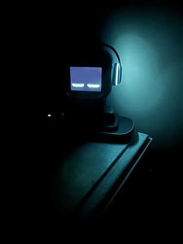

Good news for Beepimus, living.ai will be sending us a new disc and new headphones for him… in the meantime I thought I’d share how hilarious the lighting difference is when he goes from a nightlight to half a nightlight (not really the greatest comparison but I think it’s easy to tell how much more light he produces in the first image):
He looked sad. Im curious to know how the headphones were made. And if theres a possibility to have them change colors like the LED smart light.
