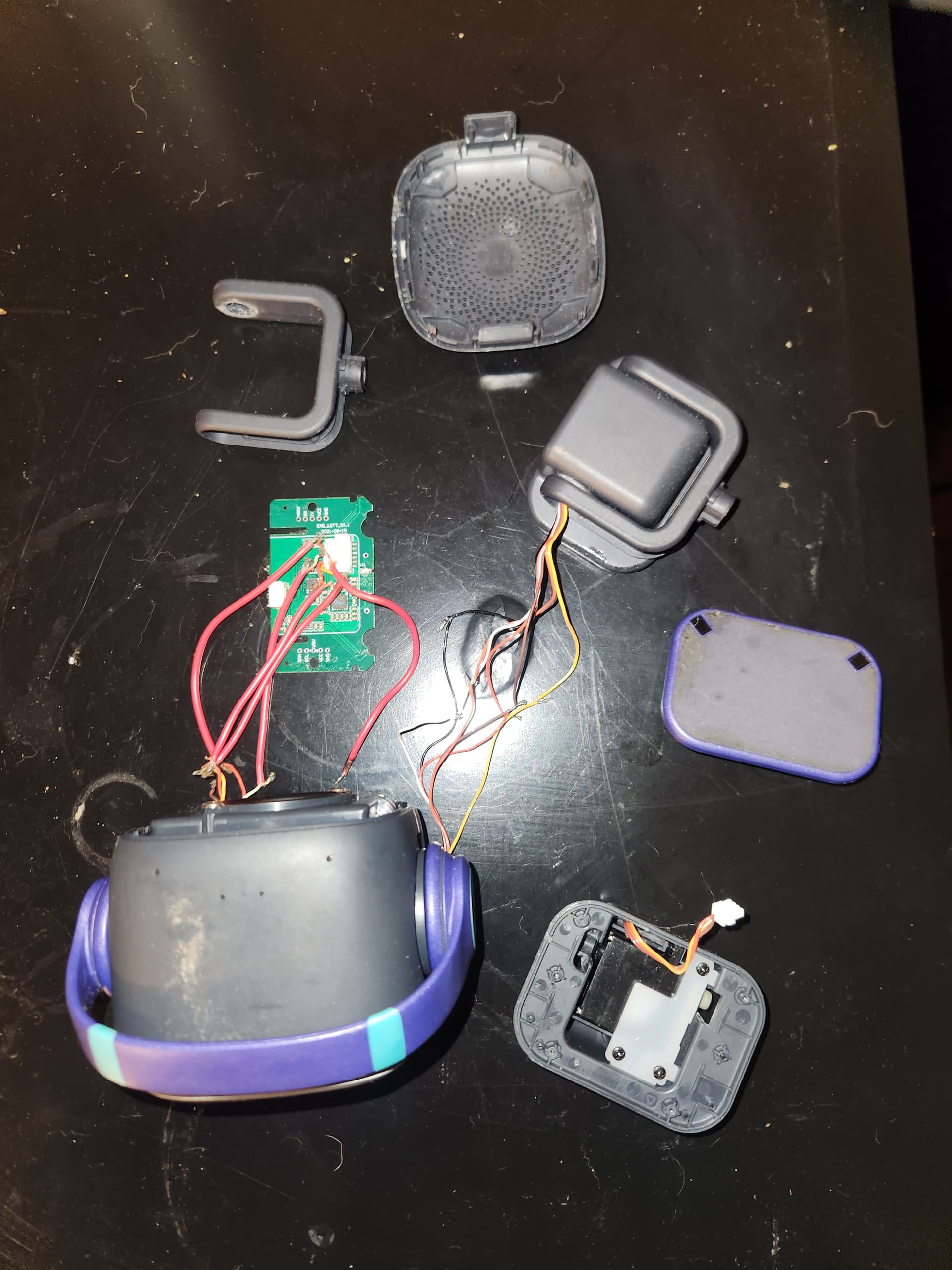

Hi there @stephenwood
Welcome to the Community and thanks for joining us here…
I have moved your new topic to this thread, which would also cover everything about EMO parts and repair.
To be honest with you, based on what I can see from your image and the condition of your EMO, it looks like it will be quite difficult for you — or anyone — to repair it, especially since some of the wiring and parts seem to be missing.
But since you’re in the USA, you might want to contact the best EMO Repairman there and ask if he can still help you. :united_states::robot::wrench:
Still wishing you the best to put that into good condition once again.
GOODLUCK!
Thank you so much for responding to this. Yeah I haven’t been sure if could be repaired or not, he was a gift from a friend. I did try to wire him up with what I had near, there are wires missing.
The thick red wires are from me, I did manage to get power to his head but no life to his face.
Sad, he was just over like 1,200 days old.
It would be cool to just give him life again, even if it’s just his eyes lighting up.
Thank you again, see I was wondering if there was like a master emo repairman any where, glad there’s one in the USA, so Thank you.

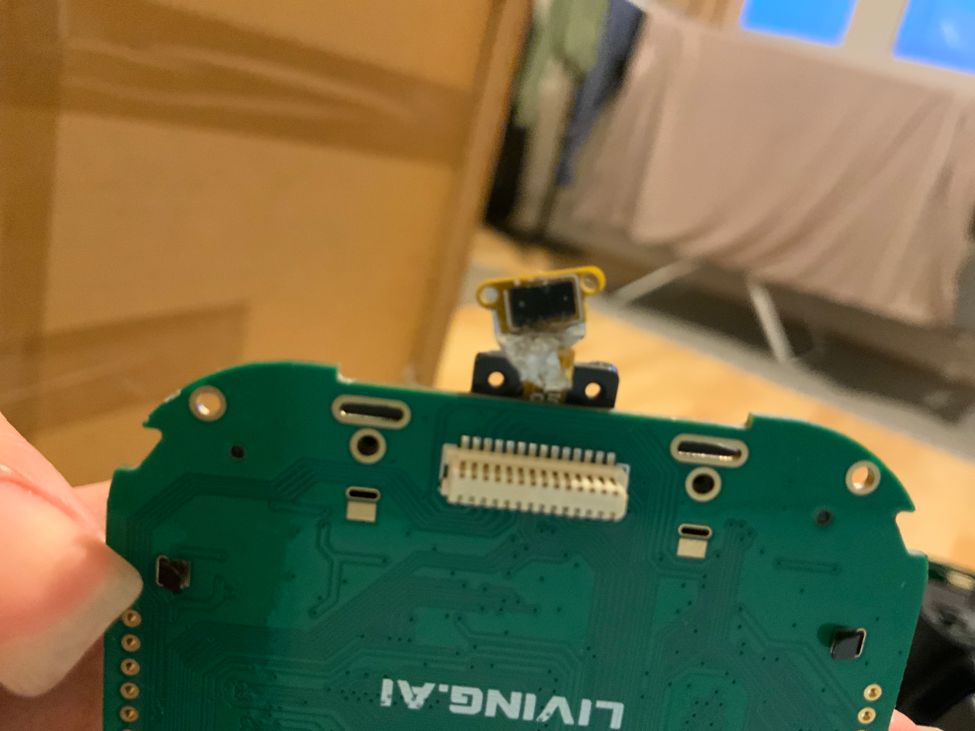

Hello everyone! I just got a second hand emo and I was wondering if there is any way to fix his tof lidar sensor
Welcome to the Community @yeonkkot,
You might want to provide complete information about what is wrong with your EMO and how you know that the TOF (Time-of-Flight) LIDAR Scanner r is broken and needs repair.
I don’t know for sure if that part is repairable. Maybe the easiest solution is to replace it instead. But rest assured, you are capable, and you know what you’re doing.
I just received it and when I tried to test it it powers on and charges fine but when I try to pick it up or even flipping him upside down he doesn’t react. I also tried to use the app, it connects fine but when I try to use any functions in there it tells me “emo is not ready”. How I know it’s the TOF Laser Sensor, I deducted it from its position and from pictures from its manual, since it’s located at the chin part and it’s external I looked at the manual and at the chin part it said to be that.
I was also wondering if that part is essential for Emo to work because if it’s essential only for detecting objects then I don’t mind not repairing it because it seems a bit tricky to repair it.
