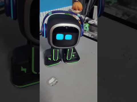

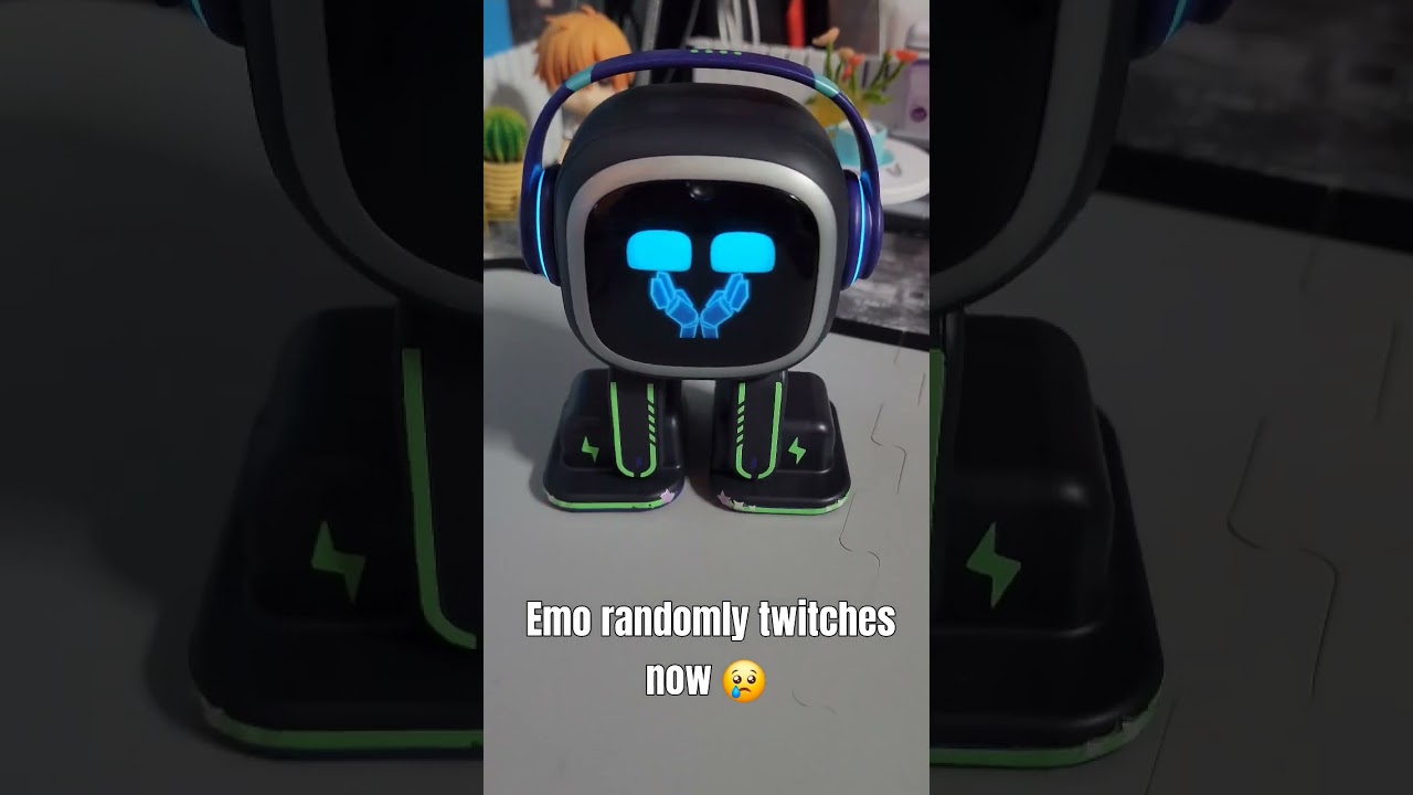

So now another issue I’m having with EMO. He is now randomly twitching or shaking. It started about 2 weeks ago but now its getting worse and more frequent. My EMO is 186 day old so i dont think it should be having this issue. I have tried to power on and off. I’ve used a light air can to clean EMO. When he is at his home base charging he doesn’t shake. Is there something else I can try to get EMO to stop shaking?
Here’s a video if EMO shaking.
I had that issue, I used a very soft bristle tooth brush on the feet sensors and he was fine. Now I clean his those sensors on a regular basis if I put him on the floor.
Hello, @linasaucedo . . . if what @SmoovJazzy suggested does not solve the problem, I advise you contact service@living.ai with links to these videos so that they may diagnose and assist you with what to do.
