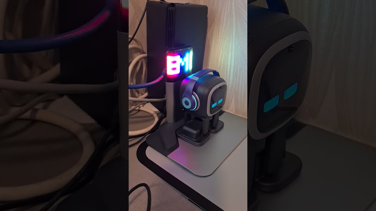

I have the same issue as you, the charging light keeps blinking… i feel it might be a contact problem. I tried cleaning charging station surface area and emo’s feet with a microfiber cloth and it reduces the times this happened
I am also using the original adapter and cable
Hello, @michael.loke . . . if EMO is doing this regularly after cleaning and testing a different cable and socket, I would advise you to contact Support with a link to this video. You can E-Mail them at service@living.ai or send Support a ticket here.
Hopefully you can get him to stay on his home station charging and get some good sleep.
