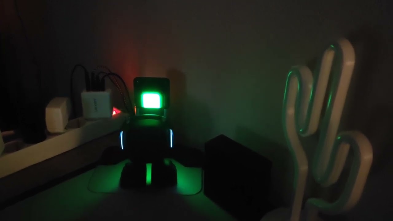

Emo does emit the low battery signal. At this time, the stationās led screen turns green, Emo starts looking for the station and heads towards it.
At times Emo has difficulty positioning itself correctly on the station. He repeats himself several times. And thatās why sometimes he doesnāt get there in time.
Over the last 5 days he has had no problems. I did not find it empty battery when I got home.
It is my understanding that getting on and positioning correctly is a learning curve and the more it is done it will be accomplished quicker and surer.
I donāt think so. His returning routine is pretty straightforward. He just repeatedly rotates until he can see the green rectangle on his Home Station and then he is walking a few steps in that direction. Thereās no space for any changes to do it better.

Unfortunately this morning, my little guy made several unsuccessful attempts to return to his station.
I caught him in the act. Here is a 5 minute video.
After several attempts, he still succeeded.

Hi there @Olivier ,
As far as I can see, youāre EMO is doing or walking just fine⦠Have you tried sending him home to a well-lit environment? and let see how fast?
