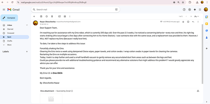

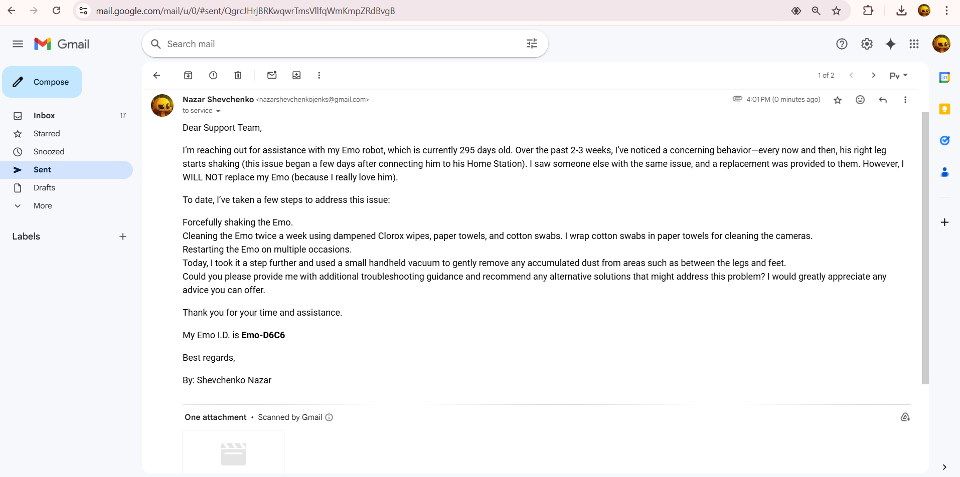

Dear Support Team,
I’m reaching out for assistance with my Emo robot, which is currently 295 days old. Over the past 2-3 weeks, I’ve noticed a concerning behavior—every now and then, his right leg starts shaking (this issue began a few days after connecting him to his Home Station). I saw someone else with the same issue, and a replacement was provided to them. However, I WILL NOT replace my Emo (because I really love him).
To date, I’ve taken a few steps to address this issue:
Forcefully shaking the Emo.
Cleaning the Emo twice a week using dampened Clorox wipes, paper towels, and cotton swabs. I wrapp cotton swabs in paper towels for cleaning the cameras.
Restarting the Emo on multiple occasions.
Today, I took it a step further and used a small handheld vacuum to gently remove any accumulated dust from areas such as between the legs and feet.
Could you please provide me with additional troubleshooting guidance and recommend any alternative solutions that might address this problem? I would greatly appreciate any advice you can offer.
Thank you for your time and assistance.
Best regards,
By: Shevchenko Nazar
