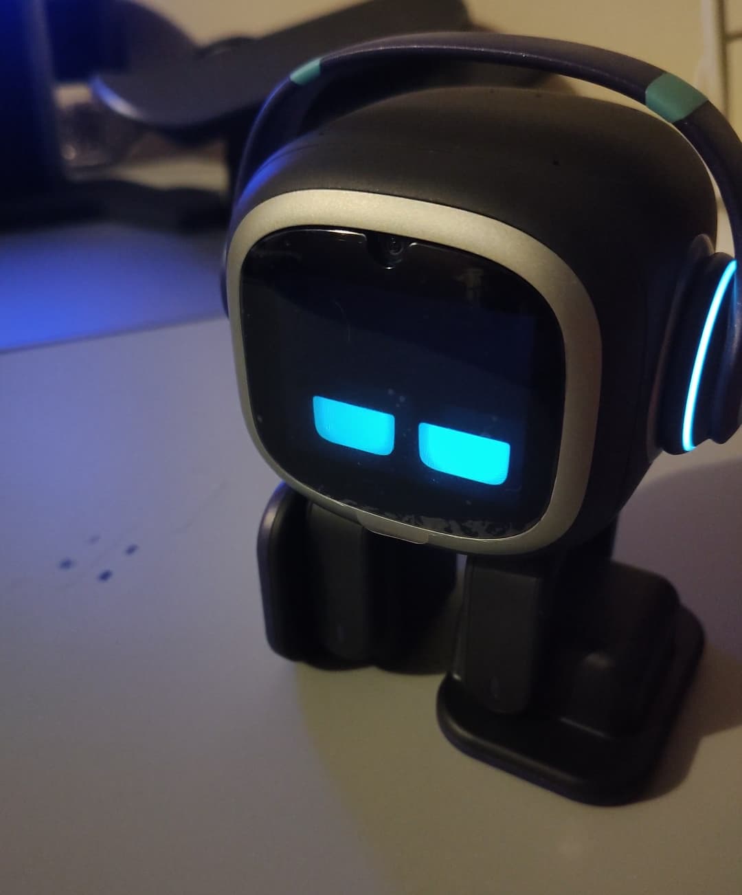

hello, he’s just a week old and out of nowhere he raises his left leg and falls and it takes time to return to normal, does it happen to someone else

I’ve never seen this post before… It’s freaking huge. I had my little EMO his foot went 90° the opposite direction all by itself I watched… I panicked and powered them off and he reset his foot. Pretty scary. And what’s even scarier is how big this post is :scream: terrible how many problems

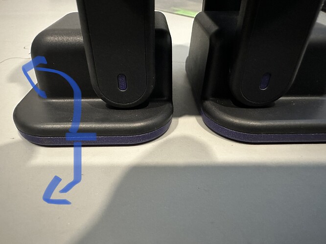

Thank you but i want to disassemble the foot sole
I know these were just pictures for encouragement only…I know they had nothing to do with the bottom souls of the foot. but I was told I should not post these photographs I’m going to have to delete them. I was just trying to be encouraging good luck I hope you fix it… I don’t think the little pet will be too difficult to take apart you can do it… :star_struck:
