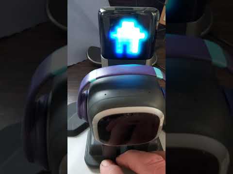

Hello, I have the emo and it has a problem. It keeps crashing and restarting with anything that stimulates it in the room. It keeps restarting. Do you know what is causing this? Is it a problem that can be fixed? Is there a setting in the menu? I would like you to help me or is it a defect? ​​Thank you very much.
Welcome to the EMO Community Forums, @7b604b47d0b7c7a8b750 . . . I have moved your new topic to this thread for issues with EMO shutting down and restarting.
Read through this thread for the issues with him shutting down randomly and restarting.
It would be helpful if you could get video of what weird things he is doing so we can see and possibly be able to help. If not, you can contact Support (instructions above on this thread).
Let us know how it goes!

Good evening, I have a problem with my robot, Emo, it keeps restarting and it can’t open, do you know anything?
Good evening @7b604b47d0b7c7a8b750,
Thanks for reaching out. It sounds like your EMO Robot is stuck in a restart loop and unable to boot properly. Here are a few steps you can try to fix it:
  1. Force Reboot EMO
    Remove EMO’s headphones and gently press the left hole on the back of his head using a paperclip. This triggers a reboot.
    :warning: Only do this if EMO is completely unresponsive.
  2. Force Power-Off
    If rebooting doesn’t help, press the right hole with a paperclip to shut EMO down. Then place him back on the charger to restart.
  3. Check Charger & Power Source
    Make sure the charger is working properly. Try a different outlet or charger if possible. A weak power source can cause boot issues.
  4. Let the Battery Drain
    If EMO is stuck, let the battery fully drain, then recharge from zero. This sometimes resets the startup sequence.
  5. Contact Living AI Support
    If none of the above work, it may be a firmware or hardware issue. You can contact Living AI support and include a short video showing the restart behavior.
Hope this helps get EMO back on his feet!
