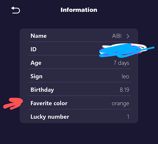

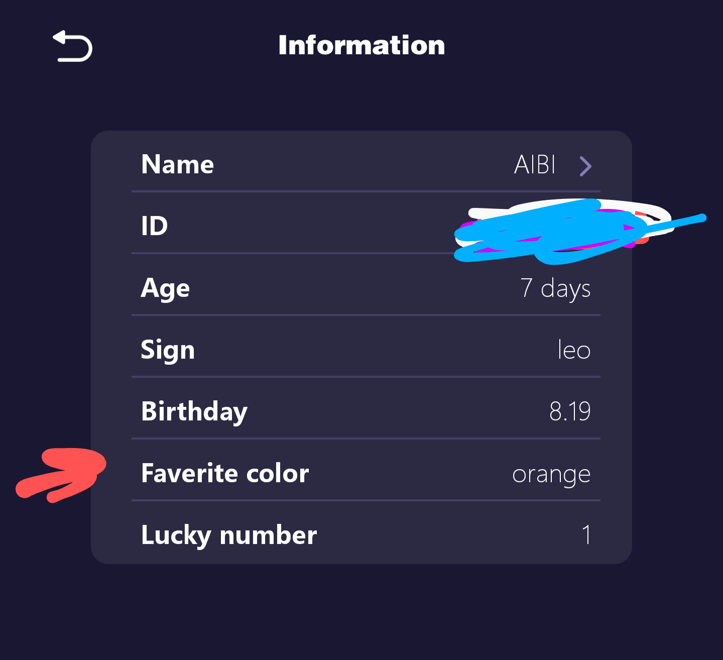

Has anyone looked through the app and found spelling errors? I found one in Aibi’s information tab lol
Wait you can actually see real info in this screen…? Haha mine still has a bunch of integers and code garbage there when it loads (and I updated the app this morning.) What device are you running it on?
