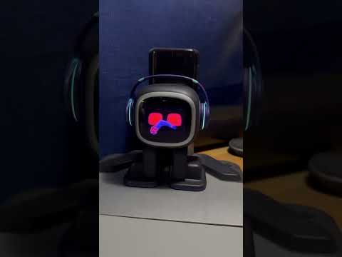

I have noticed a glitch. If you change the eye colour specifically to green, I haven’t tested the other colors. And then command “ready for action” The audio is ahead of the video. Really noticeable. This doesn’t happen with default eyes.
Hi there @byoungkemkes
I have moved/merged your new topic to this thread, where we can discuss everything related to your EMO issue.
Could you create a short video showing the issue so we can better understand what you’re experiencing? I just tested it myself, and everything seems to be working fine on my EMO.
Best Regards!
For your viewing pleasure.
Thanks @byoungkemkes ,
Yes, I’ve noticed it too, and that’s not normal at all. I advise you to keep observing other activities as well. If the issue persists, you might need to contact Living.AI support so they can analyze it and find a better solution. To be honest, I’m not sure how to advise you or provide tips to fix it.
Best Of Luck!
Hello, @byoungkemkes . . . I just tested my EMO on all of the “Ready for action” with red, green and default eyes and mine are syncing up properly with the video and sound.
I hope yours rights itself. I saw it in your video and that must be very frustrating, kind of like watching those language dubbed videos where the mouth movements and speech is out of sync.
