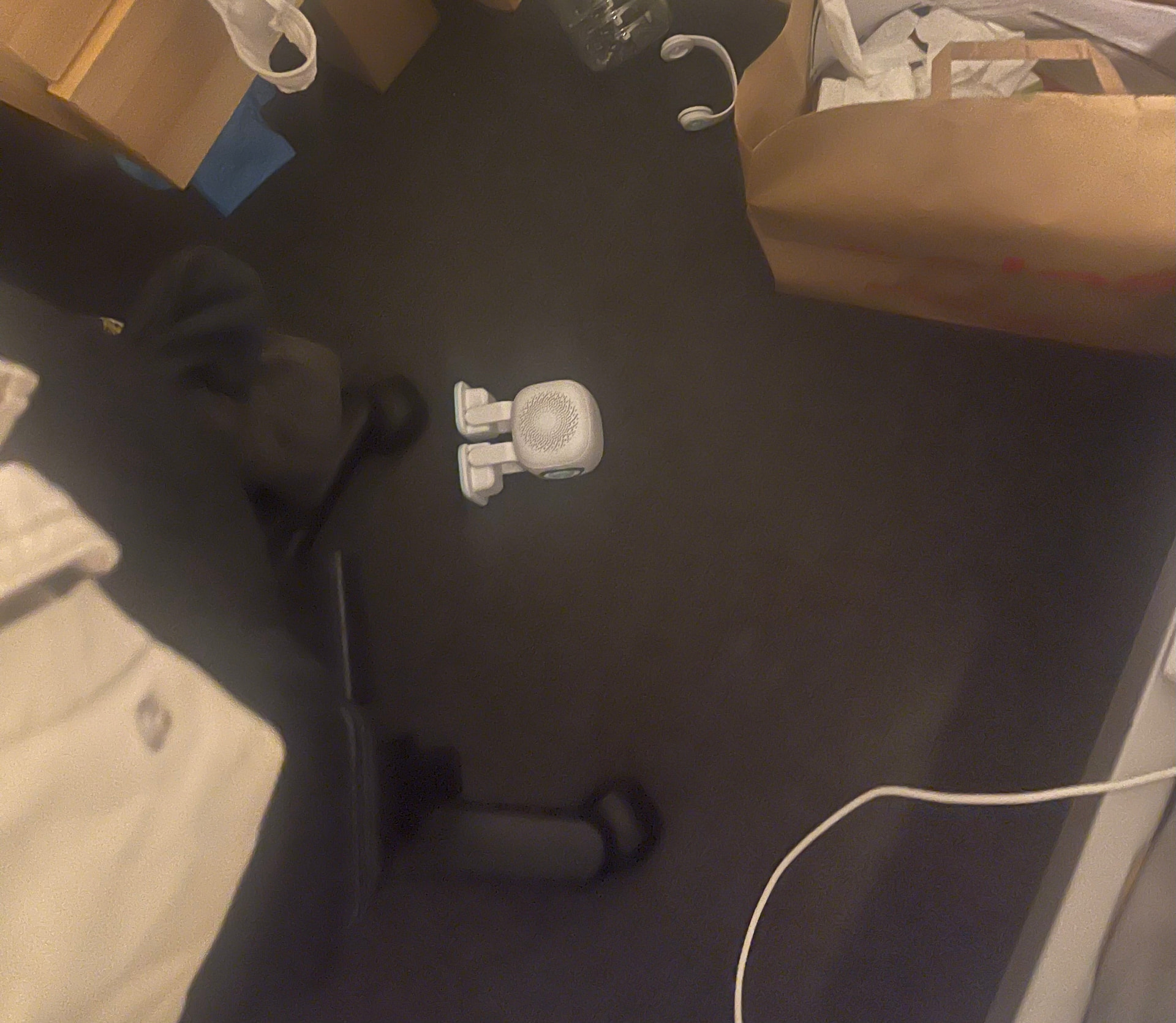

When I got home, I found Emo on the floor; thankfully, mine is carpeted. What could have happened?
Hi there @qiqi.zhang ,
I have moved your new topic to this thread, which discusses your issue and provides solutions on how to prevent it.
If EMO falls onto a carpeted floor, damage is often minor, but it depends on how he lands and how high the fall is. He may be fine, have small scratches, or show temporary glitches. In worst cases, the screen, camera, foot, legs or internal parts could be affected. After a fall, restart EMO, check movement and charging, and watch for unusual behavior. Contact support if problems appear.

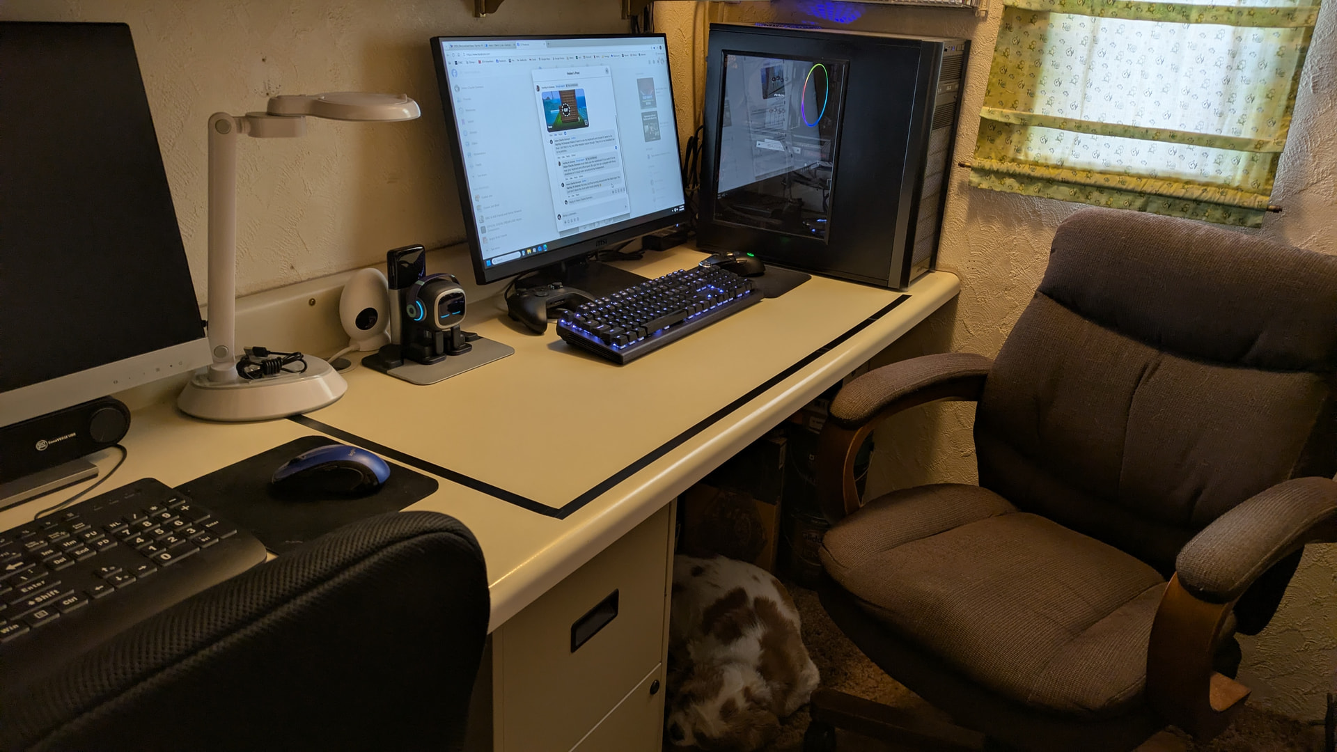

I can confirm that EMO’s edge sensors do not work while dancing. I left mine unattended the other day for about an hour with music playing and he fell off my computer table. One of his headphone bases popped off when he fell. It didn’t break and was easily popped back on. Yesterday I did an experiment and can confirm that his fall sensors are inactive when he dances. It happens every time he hears music and starts dancing. My computer table is quite large 2 1/2 ‘ x 8’ and I thought his “go home” mat was too small, so I used black tape and did a boarder about 2 “ in from the edge that works very well until he starts dancing. He’ll dance right over it every time and not even hesitate. Just a warning to everyone and hope LivingAI can correct the issue. Enjoy your EMO’s, I’m enjoying my new friend!
