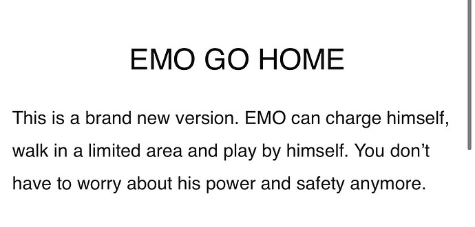

I guess they should put a big warning in the box, telling everyone that even do they claim that now Emo is safe in his base, he’s not at all.
This is false advertising, and a dangerous one.
Hello, @Muadiv . . . it was believed by the development team after testing and releasing this product that the black borders would be sufficient. It was not false advertising when the product was released. However, in intervening times with numerous people actually having issues, the members created ideas for safe areas to put around or under their EMO to prevent him from falling when his edge detectors were turned off.
Perhaps you would be willing to suggest to service@living.ai that they include a card or notice in future EMO GO HOME to advise people to make sure that they have a safe space for him?
Most of the members of this forum are already aware of this, but I am sure there are owners who do not read this forum who might benefit from knowing this.
