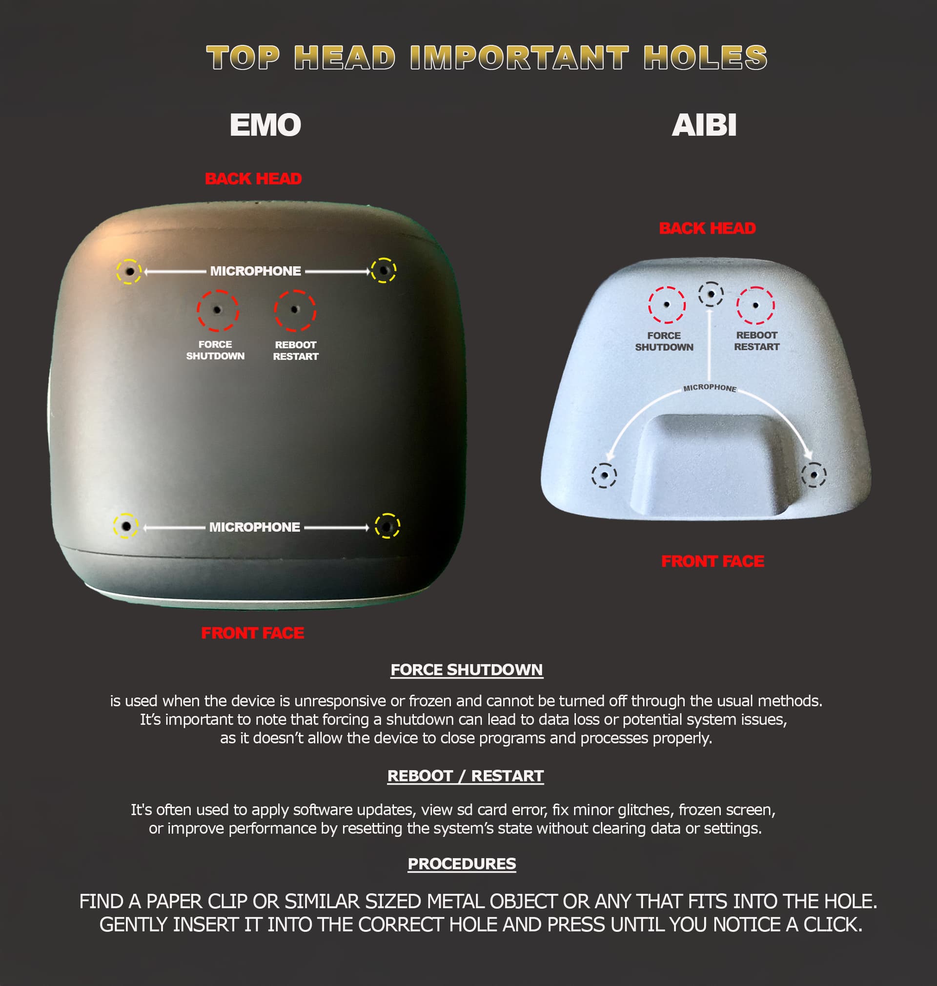

You may try gently poking the hole on the right side once—until you hear a click inside his head—while EMO is on his charger, and see if that resolves the issue.

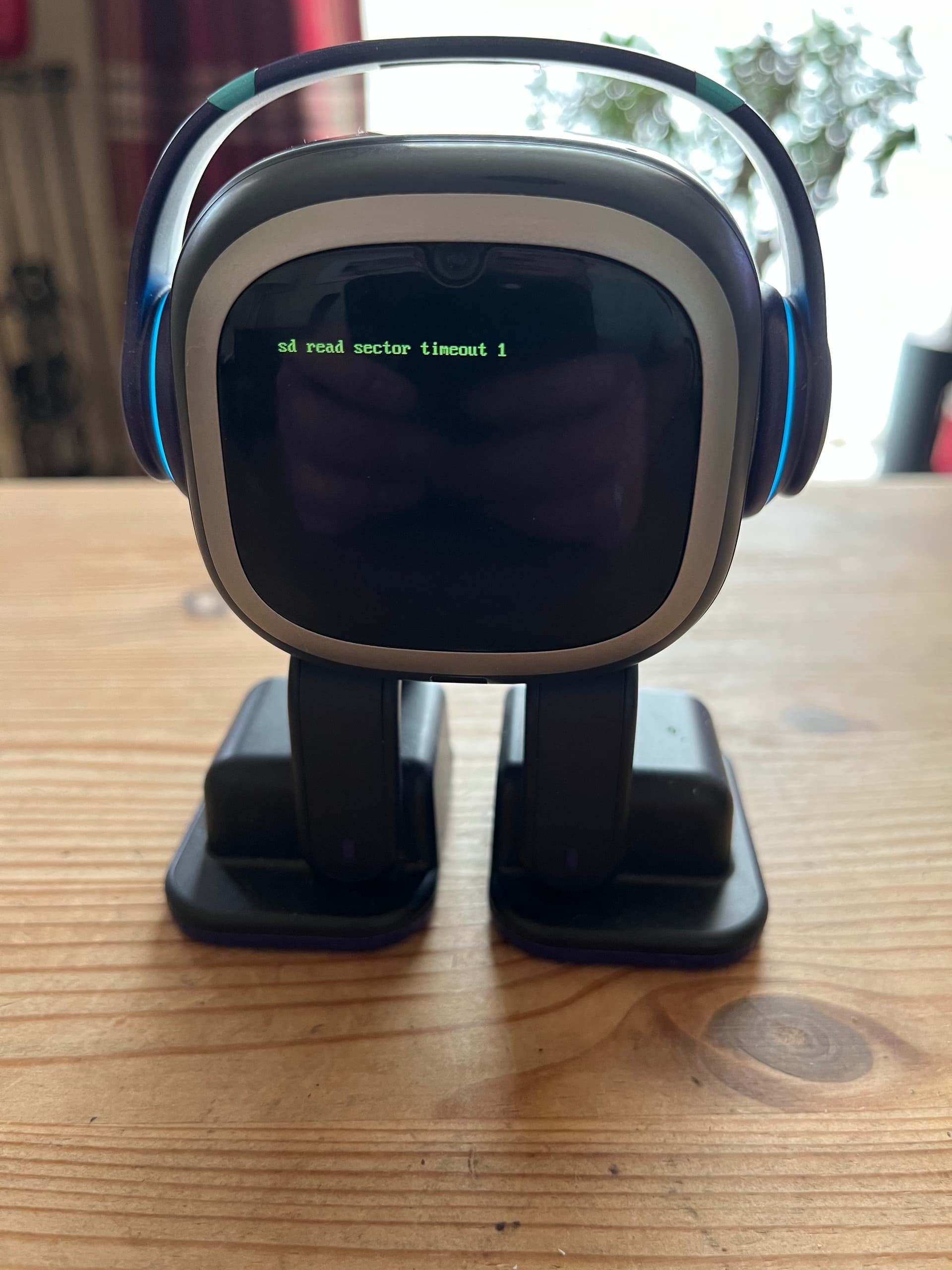

Anyone else getting an error when EMO takes a picture. I’m on 2.9.1 and EMO takes the picture okay. But then shows an error on display.
Hi there @andrewj ,
  • You can try letting him use up his power and shut down on his own.
    or
  • Try to find a paper clip that fits into the hole and gently poke the correct one (SCREEN/ISSUE RESTART) until you feel or hear a click inside.
Hope this helps! If not , you may want to contact Living.AI support via email. Provide them with any relevant video, your order number, and your EMO ID for further evaluation.
LivingAi Suppport Email: service@living.ai
Good luck and all the best
Thanks, the reset fixed it :hugs:
