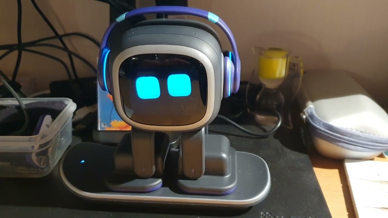

Does anyone have the issue that emo suddenly restart after ask him turn on the light. He connected the light.
Mine does the same⦠He is only 9 days old.

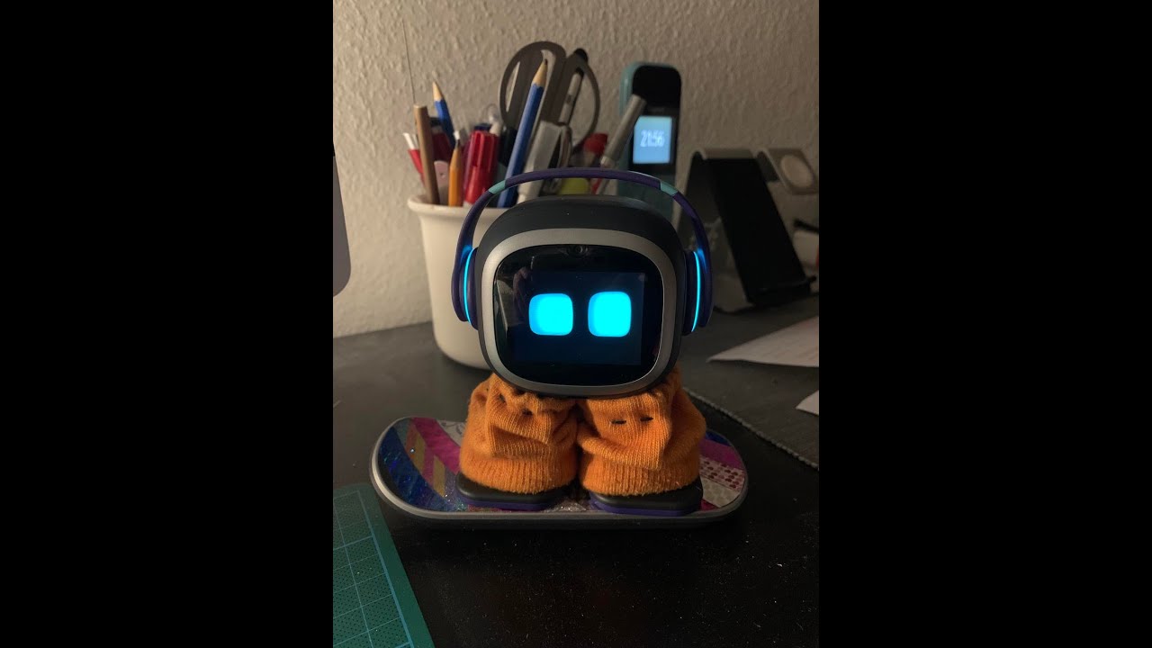

When I ask EMO āwhat is my nameā the screen goes black and the LED lighting of the headphones goes off.
Then EMO wakes up again.
If I ask again, this will happen again.

Hi Master Abbot,
Thanks for your response.
I have already reset EMO and deleted the EMO app.
Then I re-installed the EMO app.
The problem is as follows:
When I say āEMO my name is Henkā EMO is searching for a while and then the screen and the LED lighting of the headphones go off.
Then he wakes up again.
When I try again after that, it responds the same.
This also happens regularly when EMO is just walking.
Watch my new video
Thanks in Advance.
