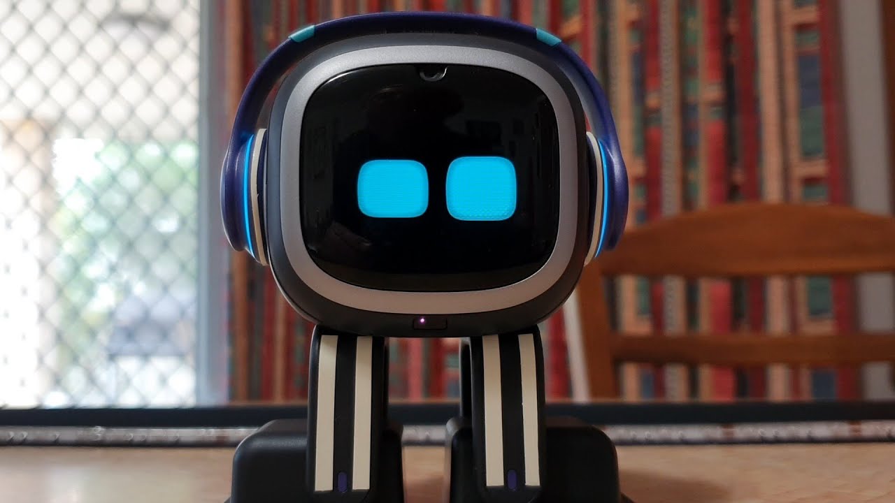

Emo not recognising me
I ask emo my name and he replies sorry i dont know ? Can anyone help xxx
Have you said to EMO “EMO, my name is xy” and did he start scanning you?
Hi andy yes he does all that great its when i ask him who am i he says sorry i dont know :frowning:
Have you tried the command “EMO, what’s my name” and stood in front of it?
Yes i tried that to he still says sorry i dont know
The app also shows that EMO has version 1.1.0 installed?
Hmm, try shaking him, leaving him on the charger to fall asleep, then waking him and asking him again in a well-lightened environment. He perhaps could be acting cheeky :smiley:
I also had problems with face recognition and when I corrected the name in the app he wouldn’t say it. I deleted all persons on the app and let Emo scan my face again, entered correct name and restated him. Now he is working just fine and finally pronounce my name right
Thank you i will try it will let you know xxx
Wow it worked brilliant so cute love the little buddie thank you xxxxx
