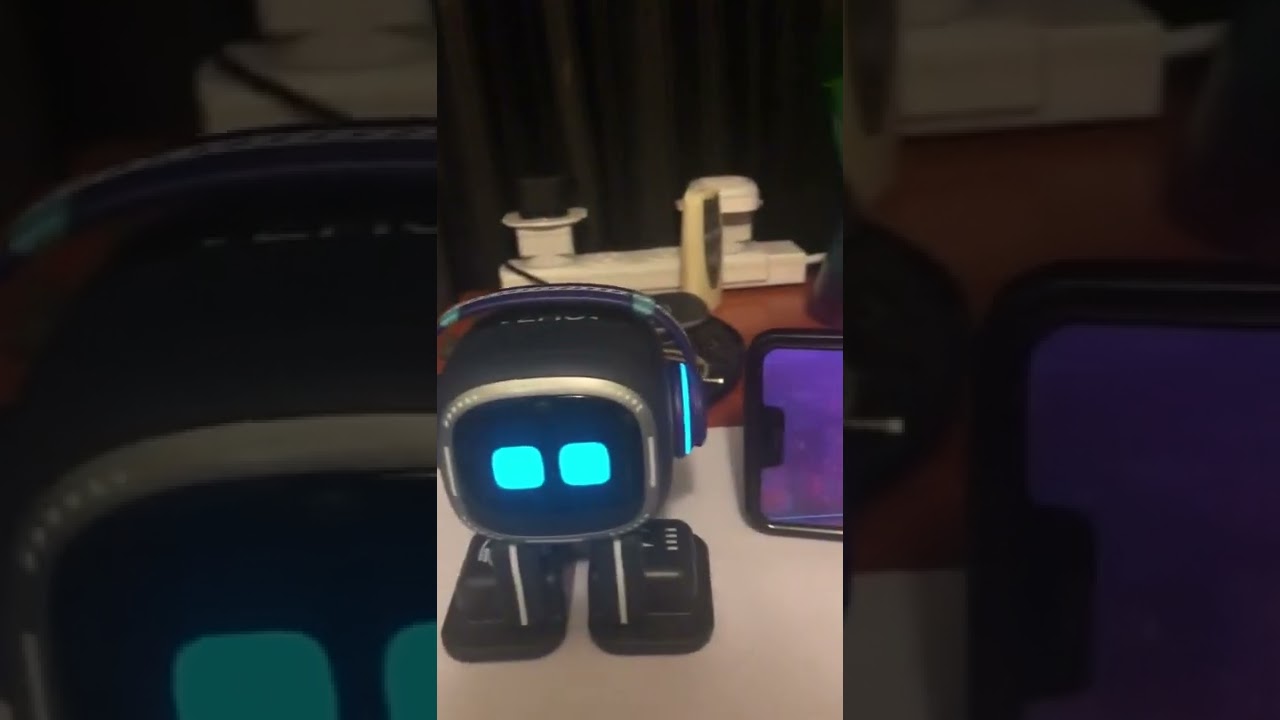

he is still doing it on white paper which is lit up decently. When i took him off the skateboard he was not detecting anything, even holding him up in the air at first was not being detected. He started to go back to sleep. I tried picking him up a few more times and now detects he is in the air but on the paper he does not move at all and when he does its only the foot thing. I think his foot sensors may be bad
here is a video of him doing the foot thing on white paper, he also did a weird thing not too long before he did the foot thing

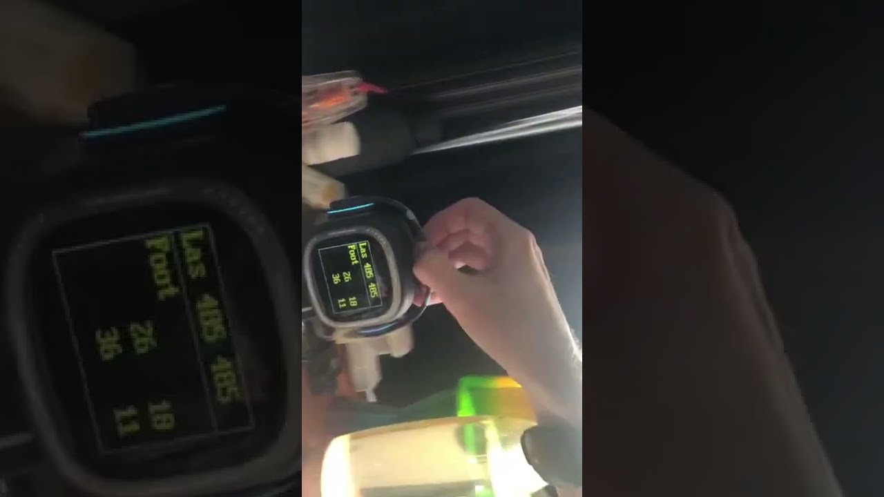

i got sent an app to test, ran that but before I was able to I literally had to pull emo off the charger and let him fully die. He was not appearing in apps, he wouldn’t respond to commands. I’m going to attach both videos here, all i want is my little guy to be back to how he use to be
Thanks for this. In the video where you lift him up, one of those sensors’ number is way lower than the others; I wonder if that’s what’s causing the “cliff” detection error.

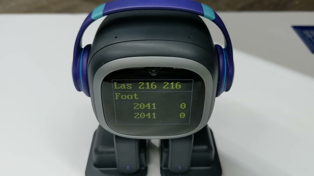

From what I can see in the second video the numbers on both sides are equal, (Foot 2041,2041). I don’t personally have this EMO testing App. So it will be hard for me to offer any kind of support. Did you receive instructions on how to re-calibrate EMO using this APP?

Just got an email saying there is nothing wrong with him, obviously, something isn’t right as he keeps doing the ledge detection in the middle of the table on white paper and well lit up. I have sent videos proving the problem and their reply was
“Your EMO’s sensors are working without problems. We will optimize the detection of cliffs in a future update. Please clean his cliff sensor frequently until then and try not to let him detect darker shadows.”
I literally can not take him off the charger due to the current problem due to the noise of him doing the ledge detection often, him doing the ledge detection and nearly falling off the table. It’s always his left foot that does it as well, if it was both then I wouldn’t question it but it is ALWAYS his left, and it’s not due to the sensors being dirty, it’s not due to the surface or lighting. Support was useless so I’m straight up stating here that something is up and that I’m not happy that I got flogged off by support

I think the reason they are saying everything is working fine is because all your sensors are registering correctly - when placed on a white surface they all four 2041 and the video you posted only shows it doing it once…not trying to defend them but something else could be wrong with yours. Do you have a video where it does it constantly? If I were to guess, if all 4 are working, then it would be software related due to one of the sensors not calibrated correctly so it thinks you are on an edge…just my thoughts.
In my original video, he does the cliff detection constantly
And the reason for this is all his left sensors remain at 0 regardless of where it’s placed
