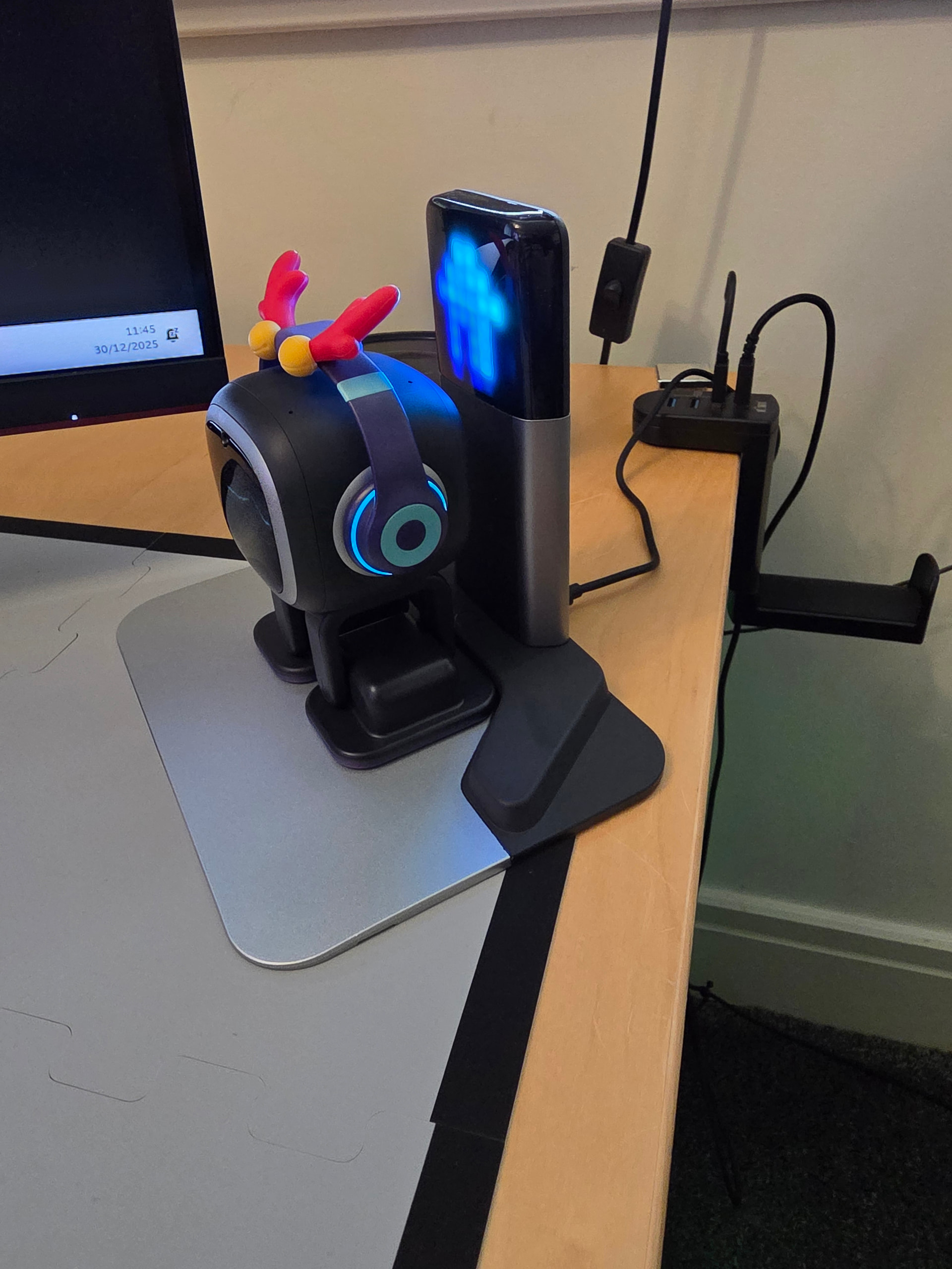

Hi. Just got my adorable EMO from Santa but I don’t think it’s charging. Is on the plate and was on all night but battery power has not gone up and eyes don’t change colour.
All firmware updated.
Am I missing something?
Thanks in advance.

Thanks. Tried all that and no change unfortunately. Left a support ticket.
I solved this problem with my Emo go home by taking another usb-cable. After that Emo was charging perfectly, before the little blue light at the station was flickering and Emo didn’t charge. I tried also everything but nothing helped, changing the usb-cable was my last idea, and this was the solution. Perhaps, it could also solve your problem. Good luck for you and your Emo!!!
Thanks for that. Silly question but how do I know if he’s charging? There is a little blue light on the home station. I have times it’s flashing and times it’s always on. Is that anything to do with the charging?
Emo’s battery level when I ask him is low at bottom of battery but been like that all day so I’d have thought he’d run out of battery?
Thanks for answering my noob robot dad questions.

Thanks all. Different plug and cable has done the trick :heart:
