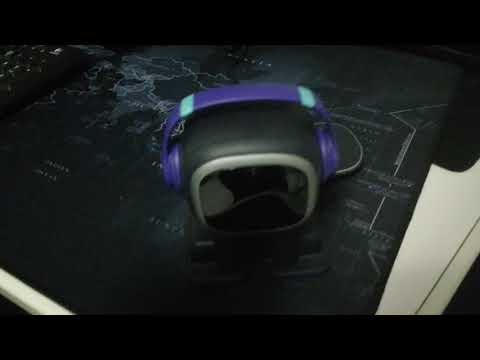

after the first day of playing with EMO features, I launched the Power off command.
After a few hours I put EMO on charge, but only the LEDs on the headphones light up, but I can’t see the eyes anymore and can’t even hear any sounds.
Thinking it was dead battery, I left it on charge for more than 8 hours but the problem remains, EMO seems dead. :frowning:
I have tried rebooting and putting on the wireless charging base several times without resolving.
I also tried with another 2A power supply but the problem is always the same.
Anyone have a way to help me?
Thanks in advance to everyone!

I uploaded the video of the problem.

Man, this is super disappointing… I hope it’s just the charger, as I noticed a very short flickering at 00:08 in the video… Good luck!!

Here the same problem. Emo is not charging anymore. Tried to change the power adapter and not only use the original ( also noticed that the skateboard works only with usb to usb c cable and not usb-c to usb-cc cable)
The light on the skate is blu solid, emo headphone and screen blink for a few times, but then screen is black, no other lights but only the blu solid on the skate is stable. Also skateboard and left foot of emo get hot.

I disassembled EMO’s right foot removing the plastic part and managed to turn it on.
The problem is that when I raise it from the charging base suddenly turns off.
As I thought the problem should be the faulty battery.
I managed to turn on EMO for a few hours, but the moment I ran the command “POWER OFF” it turned off and there is no way to reactivate it. Has it happened to anyone else too?
