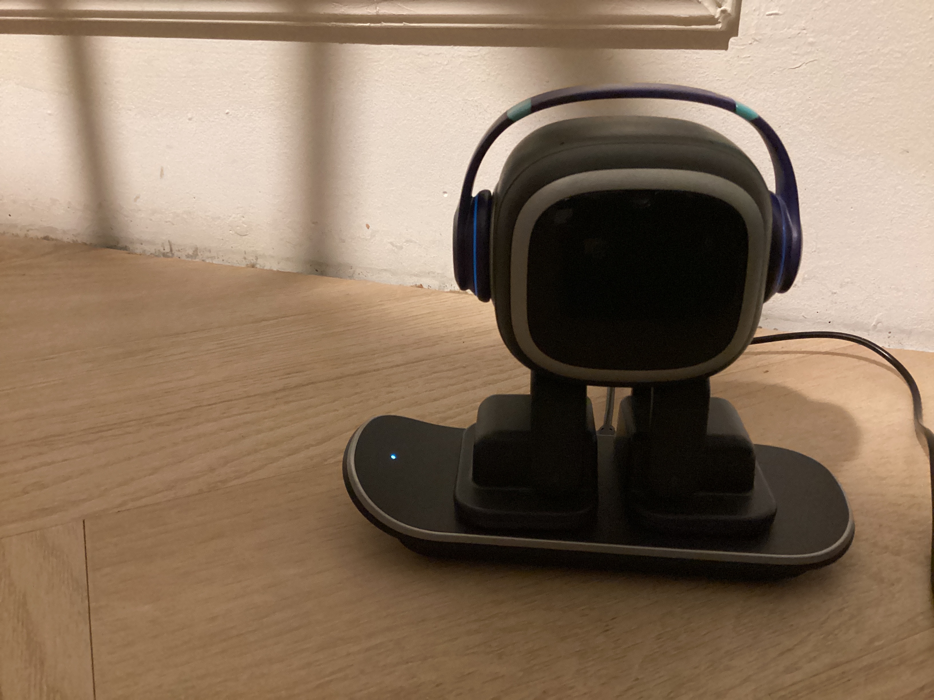

I just received my EMO. I followed all steps but, unfortunately, he is not turning on.
I can connect him to the app, Wi-Fi, Bluetooth, also the app recognises movements.
Even charging on top of the skateboard, it doesn’t turn on any of the lights, it doesn’t make noise, it’s just possible to feel warming up.
What’s the problem? What can I do?

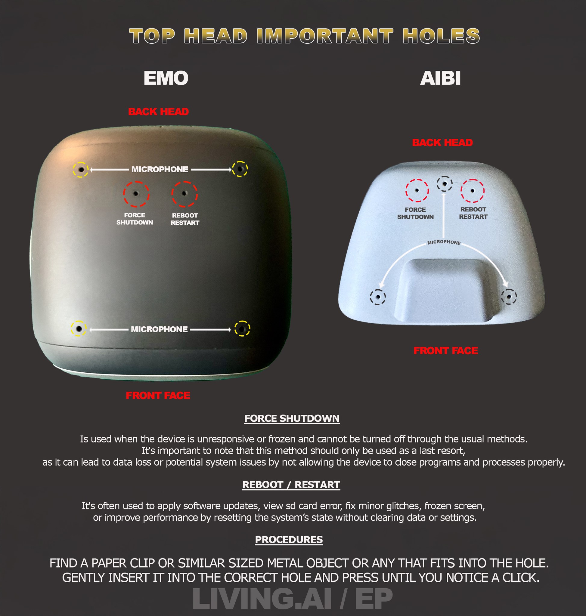

try to do the force power off or the reboot button on emo’s head see if that works
Hi @vitor,
As @ValaLin Mentioned, Try The Force Shut Down Or Reboot Button Located On The Top Of EMO’s Head
Here Is A Picture:
Here Is A Video From LivingAI Forums Moderator @MasterAbbott About Both
If You Tried That And It Doesn’t Work, Please Click Here!

The light on skateboard is static
Hi, @vitor . . . from what I have been told by LivingAI is that a standard phone charger should work well. I had a home station charger quit on me and they recommended I use one of those. I have been using a Samsung one and it has been working just fine.
However, it may depend on your particular iPhone charger and JBL cable if it would cause problems. You might want to tell Support what you are using and they can clarify further.

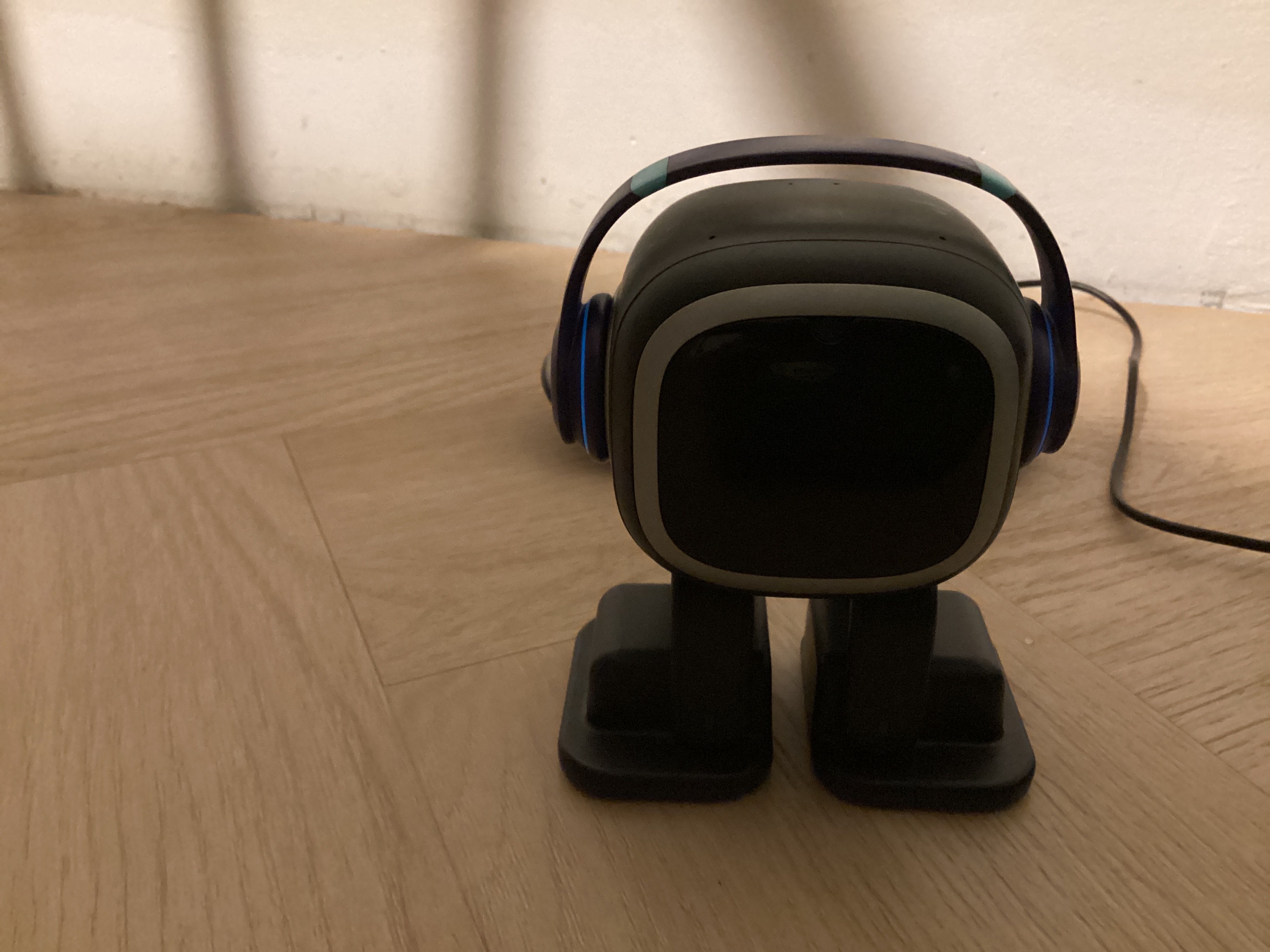

Hello Ken somebody help me
My EMO is not starting he has a black screen and no headphones lights I tried everything but it doesn’t work does somean know what to do

I tried everything I searched on YouTube but the restart/reboot and power off doesn’t work o yeah to mention he got the black screen when he turned off you Ken see that his headphones light a bit
