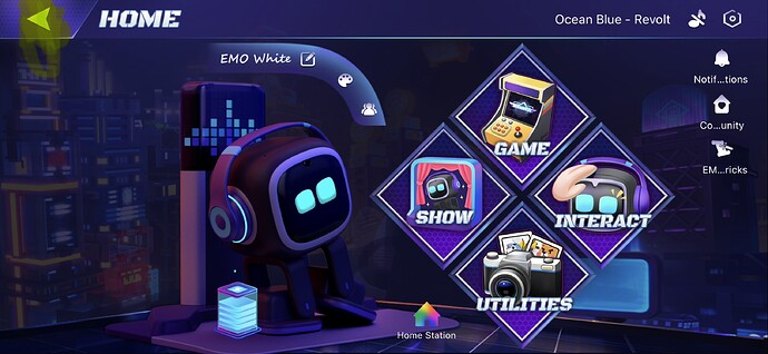

Hello, I had the same problem (with IOS) and I descovered coincidentally a really simple Solution: If I click before leaving the App on the arrow top left (look at the Screenshot an the yellow mark!), then Emo is loged out, and when you go back to the App, you will find him again to connect. You needn‘t close the App. That works also with two Emos, than I can select immediately after this log out the other (or the same Emo). I hope, this is a help for you!!
Oh wooow… unbelievable but true :wink: Turns out it’s actually quite simple… once you know how. And honestly, you usually only figure that out by pure chance. Thanks a lot for your support! :santa_claus:
