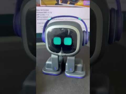

the EMO, it’s like this and it doesn’t stop, what do I do?

Hi @natansalles
I’d suggest, trying to take the screen protector off.
this section circled can cause conflict with EMO edge detection / surroundings.
So maybe take off the screen protector, power Off EMO, then also try and clean his feet / feet sensors. And also try and place him on a white surface as well.
I took it off, but it keeps falling down

Hi @natansalles
Ok, if you have taken off the screen protector. Power EMO OFF. Clean his feet as best you can (see video here - https://youtu.be/EKOj2cS7JtA
Also be sure to clean in the sensor areas for the feet and also where I circled in the image above. Once all looks clean, power up EMO once again.
Place him on a white surface / good lighting and see if he continues to do this.
If he is continuing to do this, take a new video with EMO doing this on a white surface ( as support will ask you to take a video of EMO doing this in a well lit area, and on a white surface, and send/submit a support ticket.

how do you turn it off?
Probably the best way in this situation is to turn him upside down and cover his head and wait 5-10 seconds and he should power off. (see video here for help)
There are other ways to turn off EMO, but the upside down option should work.

mine does the exact same thing now I’m positive it’s a software glitch probably introduced in 1.7… He does the exact same thing nonstop forever. It took some effort but I managed to reboot and and he settled down.
