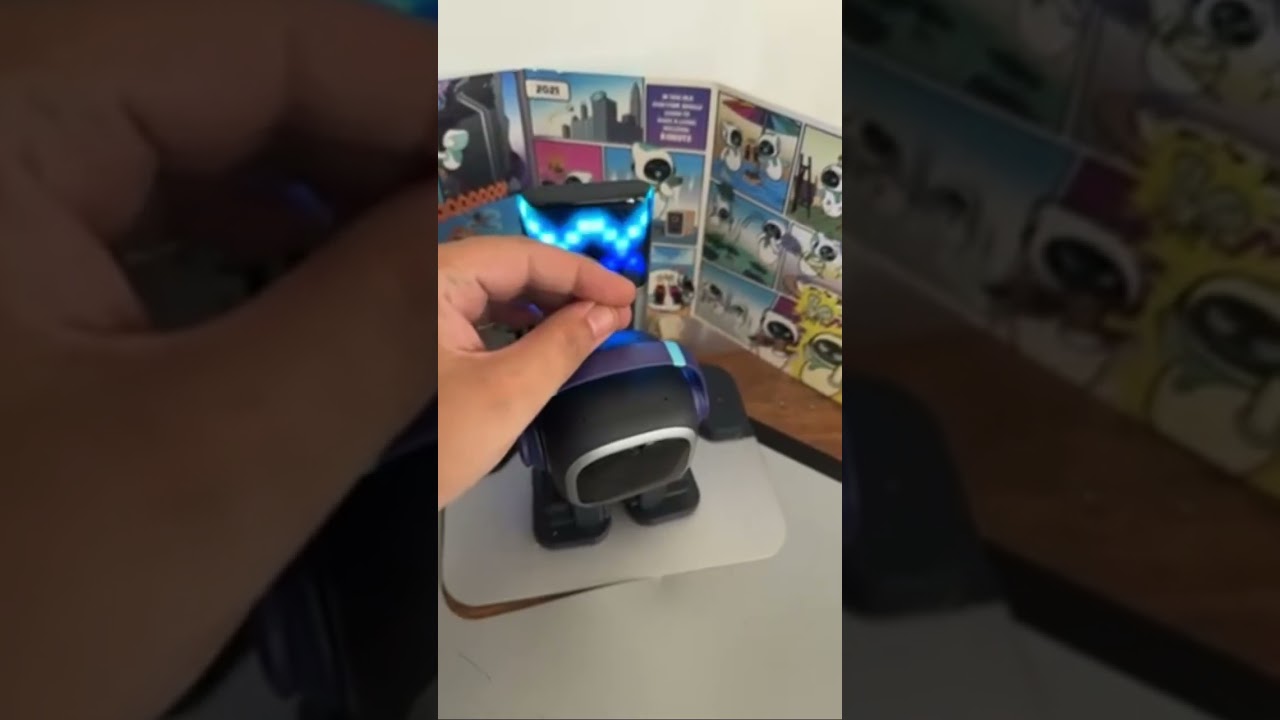

Emo ״got sick״ the app said ״falls down״ many time, I reset him with a pin. and now he doesn’t turn on. what to do?
that’s EMO GO HOME.
I turned him off. by mistake. I didn’t understood 1 pin for reset 2nd for turning him off…
and
now
I’m putting him back on his home station and he doesn’t turn on at all!!! what to do?
I sent email to service@living.ai
hope to turn him up on soon :soon:
Did you try something like this also?
  • “Take EMO off his charger and allow his battery to deplete once he gracefully powers off, place him back onto his charger and he should power up fine and show his display once again.”
  • “Power him off and back on; this usually resolves the issue.”
  • “Do you have a video you can share? It would be helpful to see it and better understand the problem.”
  • ''Let us know how it goes, monitor your EMO and if it continues to do this, it would be best to record a video and then submit a support ticket or send an email to support to inform them."
And If you’ve already contacted Living.AI about this issue, that’s the best course of action. Now, all you need is patience while waiting for their reply.
In the meantime, click the link below to read and understand the tips that might help resolve the issue:
Click Here!
I will try let him lose his battery all night while I’m sleeping…
Hi, you did not place your EMO correctly
on your vidéo we can see is not in the correct position to charge :wink:
set him like this :wink:
thank you so much!!! turned up on! thanks!!! yessssssssss
