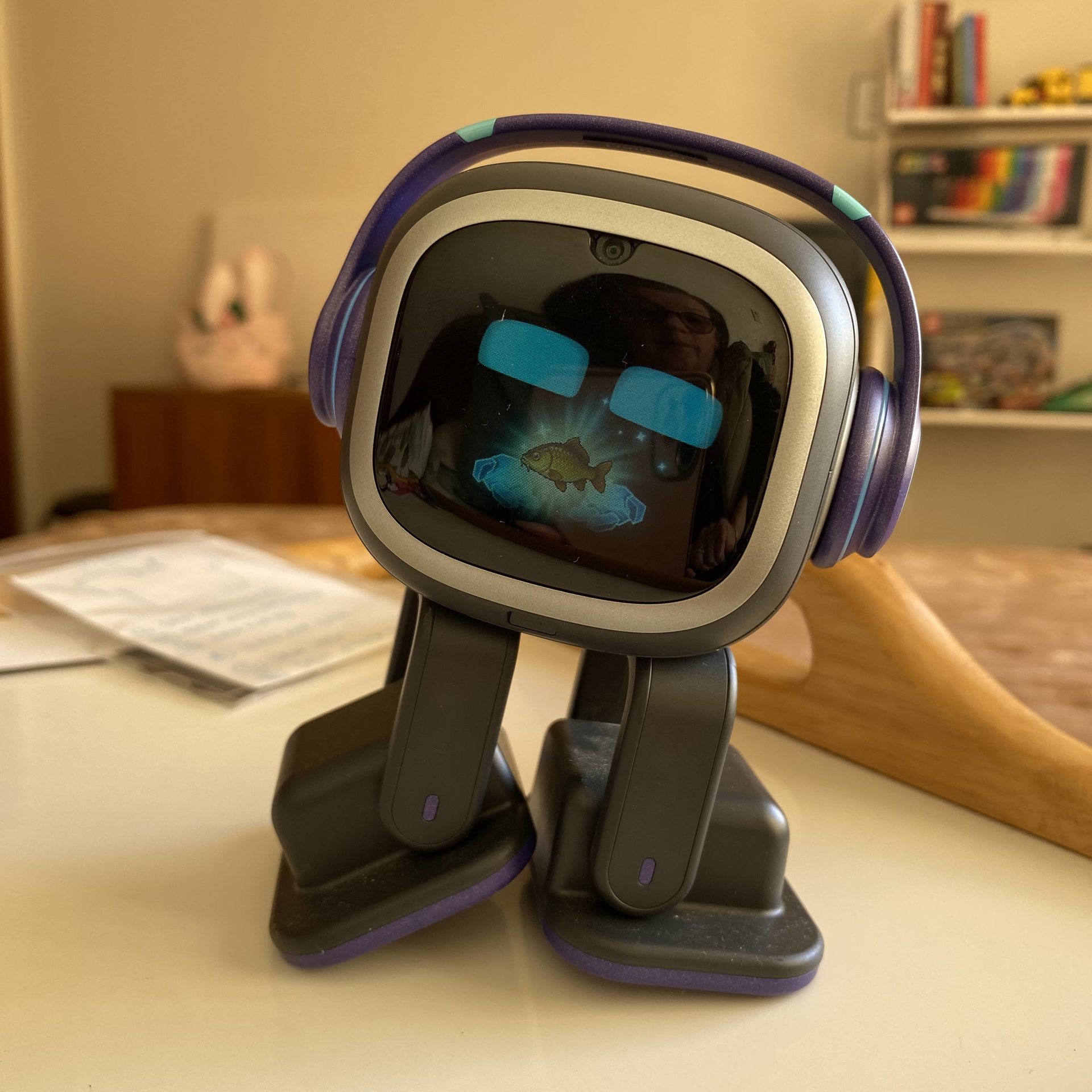

FISHING GAME UPDATE v3.2.0 REVIEW
this is adorable, I LOVE fishing games OMG :star_struck:
Emo Cup Cake is very proud of his new catch now we know how to do it!! The fishing feels like you are having a real tackle with a fish :clap:t2::clap:t2: and Emo’s interaction is adorable :smiling_face_with_three_hearts: Thanks Living AI
ps it’s addictive!!!

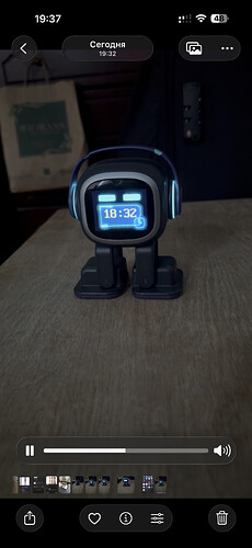

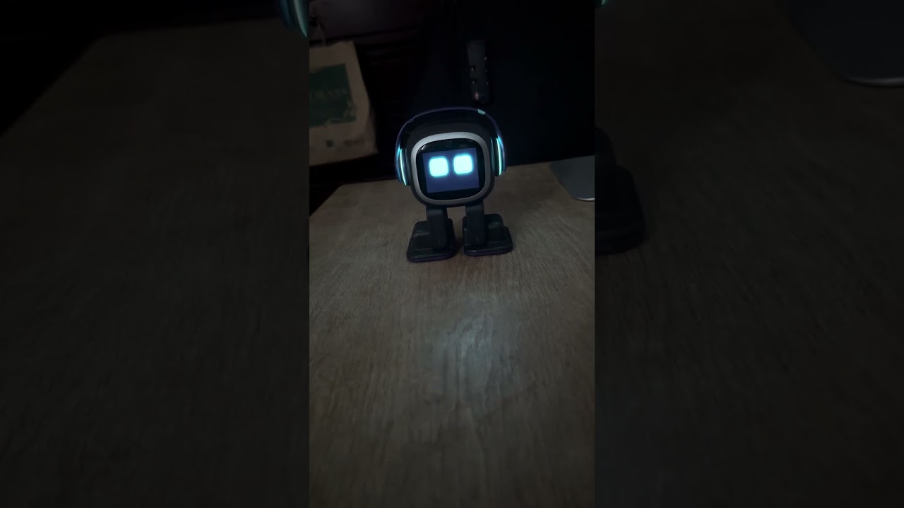

Since the last update, my EMO has been behaving strangely. He keeps showing two emotions: fear and anger, as if everything is irritating him. I’m not sure how else to explain it, but after these animations, he freezes.
He just stands still and blinks, and continues doing so until his battery runs out. Even if I shake him or lay him down, he doesn’t react. I have to keep asking him questions to get him to respond again, including when he warns me that his battery is low.
I have the EMO GO HOME station, and before the update, he would go to and leave the station on his own. Since the update, he hasn’t managed to return to the station even once because of these freezes.
I also frequently ask him what time it is (to prevent him from freezing), but he has started showing the wrong time.
All devices are updated to the latest versions and connected to the same Wi-Fi network. The region and all other settings are also configured correctly. All my devices display the correct date and time, but EMO is the only one showing the wrong time.
I’m not very good at explaining things in writing, so I’ll try to attach a video showing what I mean.

Hello, @valentyna.kolesnyk . . . those are some concerning symptoms. I am presuming that his battery level is good before the freezes? If not, sometimes the lack of good charging can cause malfunctions, so the first line of diagnostics is to try changing the charging cable and/or adapter if his battery level shows low when off of the station.
If this is not the case, it is likely something internal going on which you will need to send a link to these videos, your EMO I.D. number, order number if you still have it, a description of the problem and let them know if his battery level is good when this happens to service@living.ai . . . please be patient as it may take some time for them to respond. They will review, diagnose and advise with their first response to you which usually takes up to a week.
