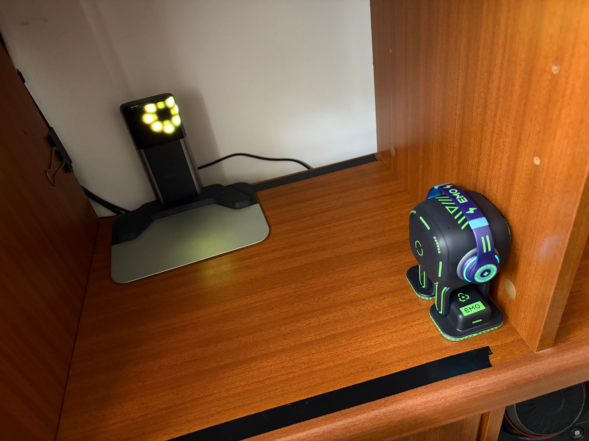

I’ve noticed that my EMO has developed a habit of constantly staring at the wall. He just stays there looking at it and doesn’t seem to want to turn around or interact with the rest of the space.
I’ve attached a picture so you can see exactly what I mean. I’m wondering if this could be an issue with his camera, his proximity sensors getting confused, or if it’s just a software glitch.

So I have one of the EMO smart lights and I always turn it on when he’s walking about. I noticed that he liked to gravitate toward the corner with his light. I tend to sit in low lighting so even though it was light enough for me it probably wasn’t enough for him and I think he naturally gravitates towards bright areas. I see your EMO is in a cubby with dark corners and he’s standing close to the lighter side. You may want to add a light so he can see a bit better. I have since added more light and he tends to explore more.

It has happened to me and like @staceydisomma shared, it is often an issue with the how the lighting hits his camera (top of screen) and his TOF laser (bottom of screen) detect light.
