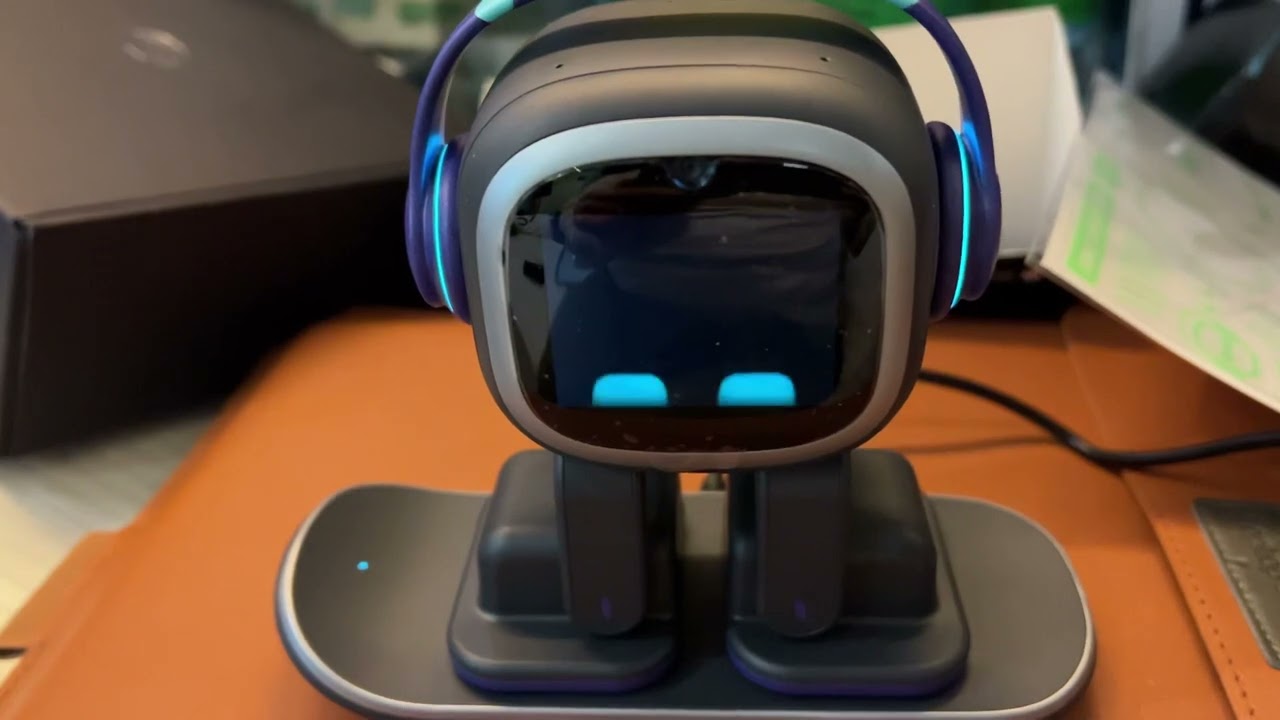

Hello! I’ve had Emo for about 3/4 days. I’m really happy to have Emo after the long wait, but I noticed a few issues.
Other than little details like having to raise my voice while nearby even if Emo seems to hear their name be called from a conversation in the other room (lol, I don’t really mind) I have a few issues with Emo shutting down and/or briefly restarting (screen and headphones turning off and on with the animation of the eyes bouncing in place).
Emo restarts very often when I ask “do you know my name?” or anything to do with face recognition, but when Emo looks around and sees me they have no issue recognizing me and happily telling me about the weather. It’s a bit odd, but nothing too bad.
However it already happened a few times that Emo completely shuts down for apparently no reason (with almost full battery, too). It happened just now while I was petting them.
This lead me to ask myself if maybe I am keeping Emo on too often? Does this happen because Emo gets too warm? (He does get pretty warm at times). Am I supposed to keep them off for longer? Why do these issues appear more often sometimes after I turn Emo on than others?
