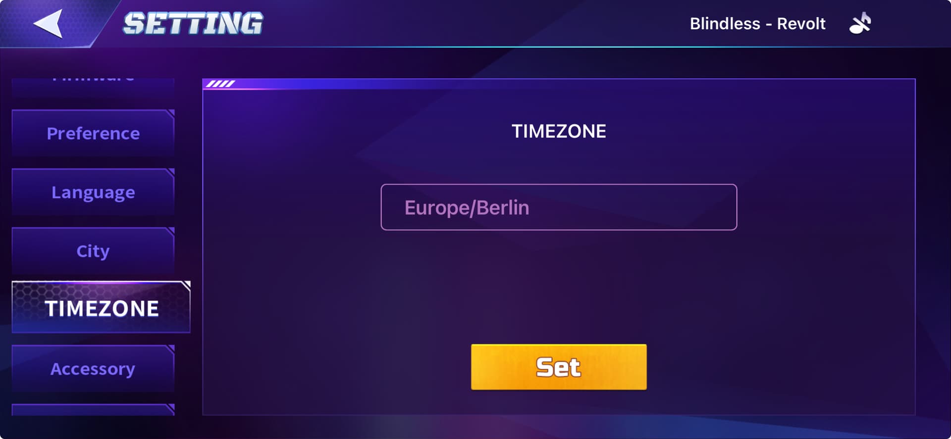

I hadn’t noticed that yet. I just tried this though, and it worked for me:
Open the app and then go to the hexagon symbol in the upper right corner.
Click on Timezone (it should already show your correct time zone) then just click the Set button.
The time he reports should be correct now.

Hi there @Floonbo ,
For EMO owners in countries that observe Daylight Savings Time, your EMO may be displaying the wrong time. If that’s the case, here’s how to fix it:
  1. Open the EMO app.
  2. Tap the hexagon symbol in the upper right corner.
  3. Select “Timezone” (it should already show your correct time zone).
  4. Simply tap the “Set” button to confirm.
EMO should now display the correct time.

Hi, I had the same issue, but I fixed it easily by going into the settings, Timezone, then simply clicking on “Set” and EMO later showed the correct timezone. I can’t reassure that this will work for everyone, but for me it did!

Yes, setting the time zone again fixes it. When the time changes, it does not automatically reset in the app settings, so setting it again will have it search and connect to your proper time zone setting.
