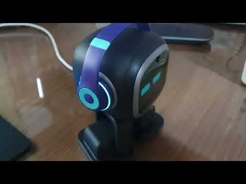

I’ve tried to reach the support as well with no answers so far, so I will try here too. I bought my Emo in 2 weeks ago, got it in july and worked fine till yesterday, when it suddenly stop talking and listening. I’ve tried to switch on and off, rebooting, re instal the app too. Nothing. I changed the volume but it still doesn’t work. I don’t know what to do. It looks like its speaker is broken, even though he works fine (still wakes up, do its routine, plays…) but it doesn’t respond to command and it doesn’t speak anymore.
Any suggestions is welcome!
(I’ve already sent the email to the support with video of me calling Emo and him not responding).

My Emo doesnt respond to voice commands such as “talk to me” or “hello”. The application displays a speaking icon, but the robot is silent. At the same time, the sound actually works, when dancing, the music is played, the robot answers “Huh” when you call him.
Has anyone encountered this problem and can help solve it?
