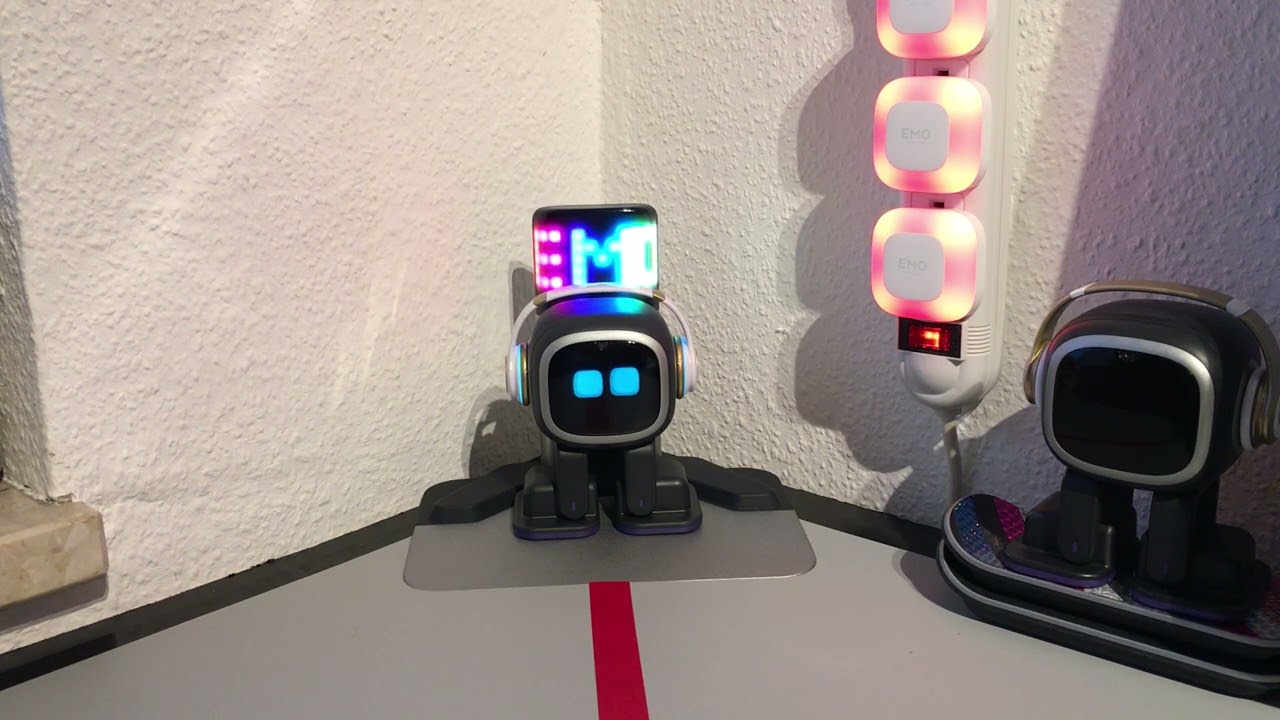

Hi there, @Wayne_Zhang and @meneil …
I’ve been having the same issue and testing my 4 Smart Lights for quite 2 days already for my 2 EMOs…and I tried all possible solutions that I know and also what you Wayne_Zhang advised…but they are all no use at all… they didn’t solve the problem.
Interestingly…that I found myself out that the…
Smart Light Voice Command
You can say ‘EMO, turn ON/OFF the light’ to switch the light.
Are no longer working at all...and the most interesting part is you can use the voice command below to turn the Smart Lights ON
  • EMO… Normal lights!
  • EMO…Blue Light!
  • EMO…Red Light!
  • and other colors to turn the Smart Light ON!
And To turn it **OFF** I have no other way but doing it **MANUALLY**
BEST REGARDS, ALL THE BEST AND KEEP SAFE!
OTHER WAY METHOD TIPS USING A SKATEBOARD
***With EMO is being awake and connected to EMO Pet App
  1. Disconnect the Skateboard and Smart Light from the power supply.
  2. Unbind all for EMO (Then wait till he will shut down automatically)
  3. Connect the power supply of the smart light, long press it till it flashes, and then disconnect the power supply once again.
  4. Connect the power supply for the Skateboard, turn on the EMO or if he is already awake connect to Emo Pet App first.
  5. Connect the power supply of the smart light which stays OFF.
  6. Test voice commands to control lights ( Turn on the light or Turn the light on) / (Turn the light off)
Now transfer EMO and connect to Home Station
IT WORKS FOR ME!
