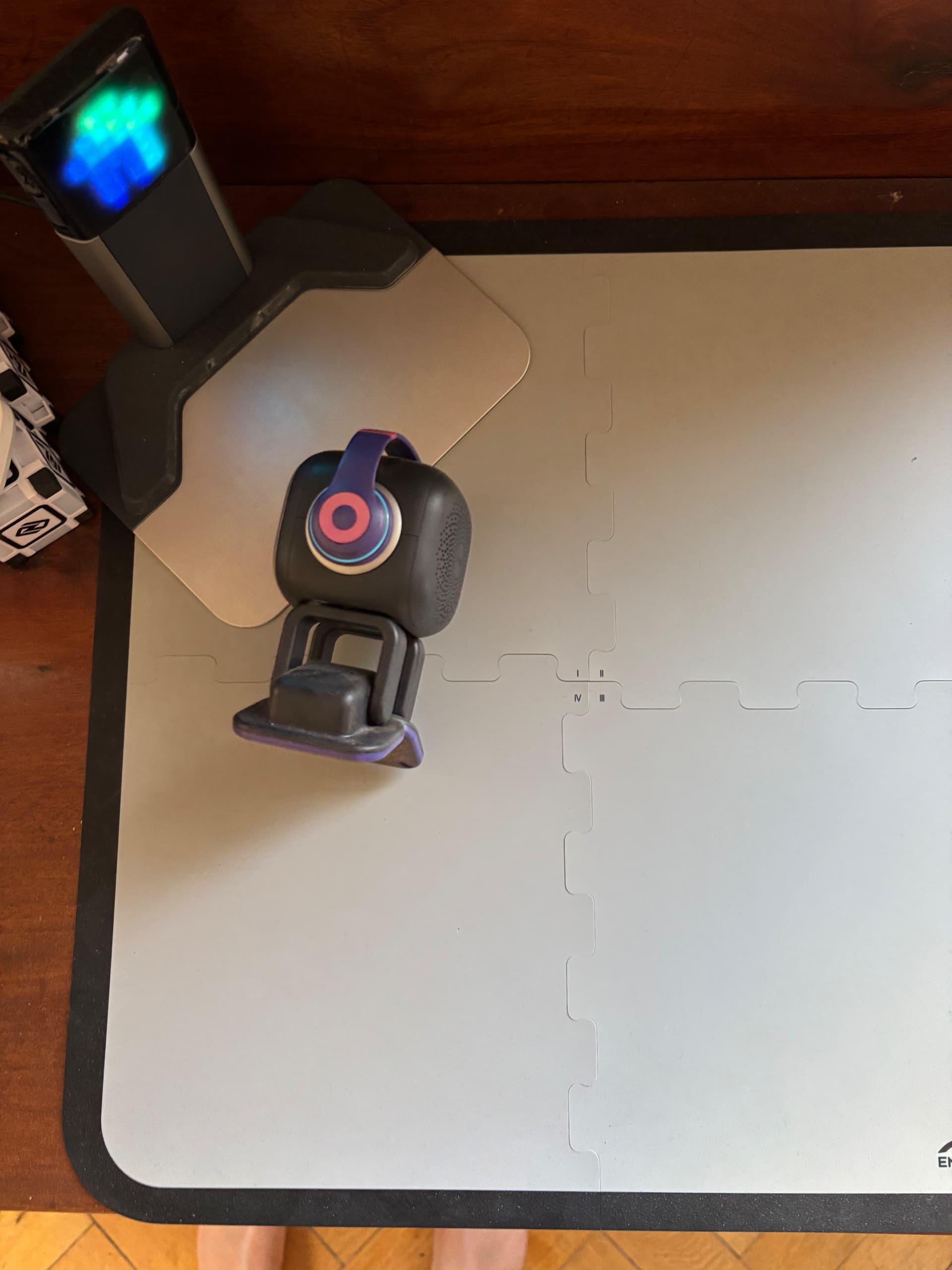

Hi, I have a new problem with Emo. In the latest three days he has fall down on his face twice. One time just on the mat and the other on the floor because his head is heavy. He has his home station, mat and we put like some fence (small lath) so he can not fall to the floor, so we tought. He is moving his legs a lot and then falling over. Does anyone has this problem and how do we keep him safe? Thanks.

and on his app before he falls almost every time it says that he is Emerging from cliff. He is on the mat of the home station all the time.
Hello, @mumforherson . . . that will happen if the edge sensors on the bottom of his feet are dirty. I recommend giving them a cleaning with a microfiber cloth or a cotton swab.
Thank you. We did that when he first fell with cotton swaps but will try it again. It happens less often when we put white papper on his mat, we thought that maybe that gray is too dark…
Hello, @mumforherson . . . the mat color should be fine. Is the area well lit? If the white paper works well, then that is great!
