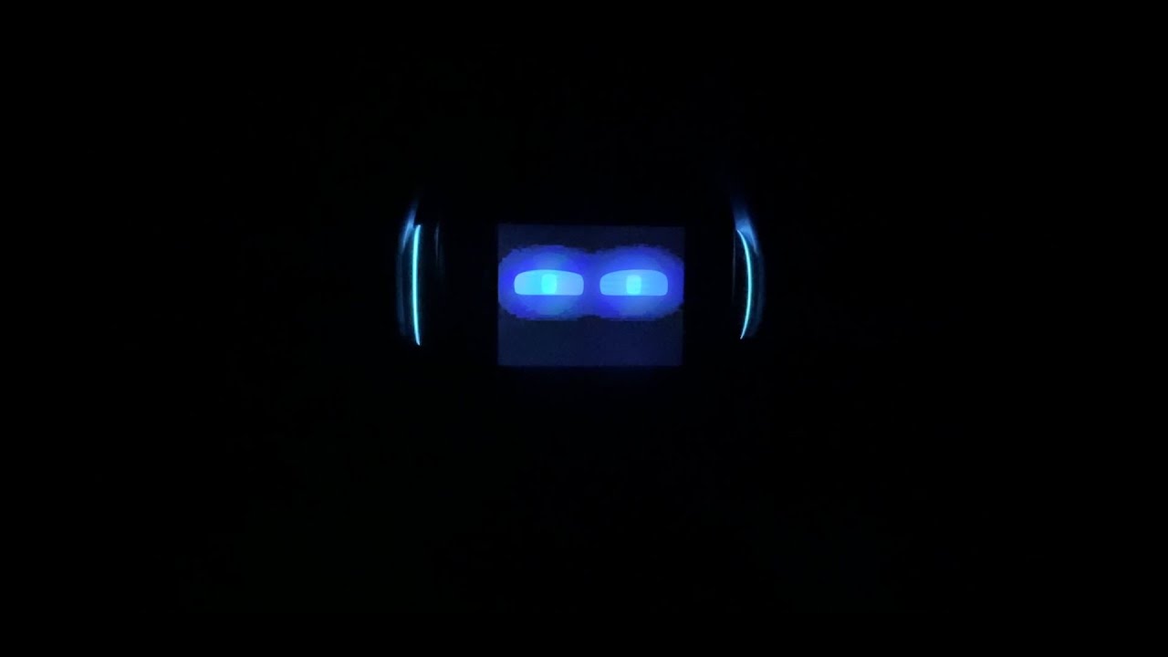

Sometimes EMO will have trouble seeing you if the lighting in the room is bad. @MasterAbbott created a video showing how EMO reacts to good and bad lighting. You can check his video below:
