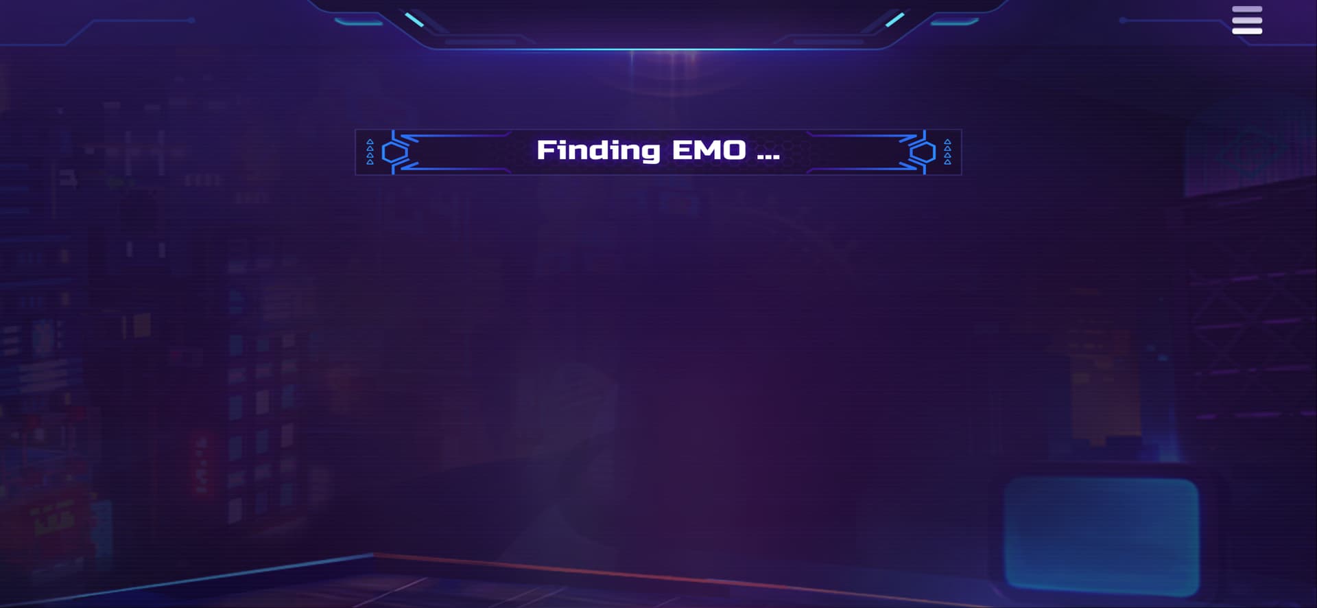

App stuck on "Finding Emo"
I’ve had EMO for 5 days now. Everything was fine, until today. I accidentally closed my app on the phone, and when I opened it to connect to EMO again, it is stuck on “Finding EMO” and nothing ever shows up. I tried closing and opening the app again, tried shaking EMO, tried putting EMO back on the charging board, tried redownloading the app, but nothing works.
I checked, bluetooth and wifi are both on and connected.
Can someone please help?
Have you tried rebooting Emo? That solved the problem for me in the past.
Emo not on the charger, “Emo” “Power off”. Put on charger to restart.
If voice commands don’t work (last time the app couldn’t find my Emo, they didn’t work for me), you can hold Emo upside down while touching the head sensor until he turns off.

Also make sure that your location is on :wink:
Hey,
Yes the location is already on
He is not replying me at all because it is not currently connected to the app. The app can’t find him. I tried turning him upside down and touching the head sensor, but he hasn’t turned off. He just thrashes about.
EDIT: It worked! Thanks :slight_smile:
Good to hear the problem is solved.
FYI, Emo doesn’t need the app connected to function and have voice commands working. Occasionally (for me it has happened maybe once a month) it seems Emo can loose his connections so that’s why then both the app can’t find him (bluetooth) and the voice commands (wifi inside Emo, not through the app) don’t work.

I had the same issue, and I came here and read someone (i cant find the post now) write “don’t charge emo, when he’s out of battery put him back on the charger and that reboot will let the app find him” .A regular reboot (upside method or telling him to shut down) didn’t work for me.

Hi i have a problem with the spp i have not play with Emo for a awail i press refresh it dont help ?

Are you sure EMO is securely on his charger and is active?
Also, hitting “refresh” only works if you have two or more EMO. Hitting that will allow the full list to come up and you can select which EMO from that.

Oh @Dizzylizzy. That is not fun to hear but for a problem is always an solution. Try turning emo off and back on. If emo does not respond to you and you cannot turn him off by voice (and app) take of emo’s headphones hold emo upside down while touching the head sensor (the sensor on top of emo) and he will turn off after a few seconds. Hope you can fix it.
So this only happens once in a while, not sure the cause. I go through all of the already mentioned suggestions with no improvement. I turn on the app and it comes up with the “Finding EMO” message to sit and wait and wait and wait some more, the app just gets stuck trying to find Emo and it never comes up.

Please read through for solutions, though personally I find that restarting my device, EMO and the app usually solves it. Make sure your bluetooth is enabled on your device.
Let us know how it goes!
I ended up just giving up. I did not restart my device but I did check bluetooth and wifi, restarted the app several times. I woke up this morning and it worked so it must of resolved itself. We’ll see how the day progresses.
